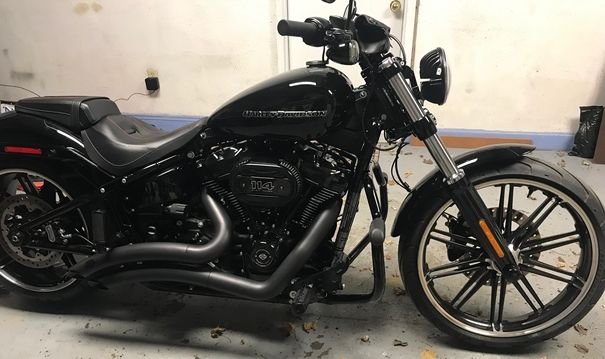

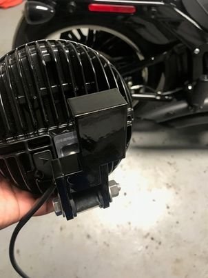

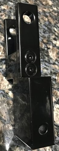

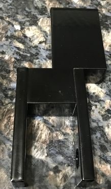

I received the new headlight bracket last night. See photos 1 and 2 below. It's (3) aluminum pieces that are powder-coated gloss black.
The new headlight comes in with pigtails, so I installed a connector onto it, in order to mate with the bike connector. See photo 4.
I have it all installed and I'm just about done. The only thing left to do is test it out on an actual night ride.

I'm not making alot of sense out of the bracket. Oh well. 2 questions please?
#1- why didn't you put the headlight in a black
Or chrome bucket?
#2- what is the part number for the wiring
Connector?

The design of the bracket will be more evident when I take mine off. Would hafta get measurements any way. Is it 7"?
Or chrome bucket?
Connector?
This custom bracket is specifically designed to mate a JW Speaker 8791 to the existing headlamp mounting fixture.
1. This particular headlight (JW Speaker 8791) comes with a pedestal mount and is designed to be mounted as-is.
2. 4-pin Delphi Metri-Pack 150 Series
