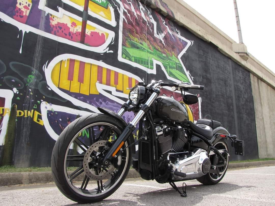

Recently purchased a Kuryakyn nova license plate holder that relocates the license plate to the left side swing arm on my 2018 FXBRS. The stock license plate holder (black) is part of the left side tail light support, so the arm that holds the plate needs to be cut off or removed all together. I would prefer to remove it. If I can find a left side tail light support that is the same length as the stock support on the right side. That way the lights remain spaced the same distance on each side of the fender. My question is does any one know if I purchase another right side tail light support can it be used on the left side? Is there a locator or an obstruction that I cannot see while the support is installed that would prevent me from installing it on the left side. Has anyone here relocated their plate & if so what did they do about the stock plate holder?
Yes,it'll work. That's what I did. I like the plate holder alot!
Very heavy-duty / well made...

Cool, thanks for the info & the picture Superdog. I’m going to order a new stock right side taillight support & use it on the left side. Looking forward to getting rid of that stock tag holder that’s just floating out there in no mans land. The tag holder looks good on your bike.

I hated that thing. Had it turned verticle, that helped, but.... Only bad thing about ours that I can think of is, might be hard, if not impossible to mount a swingarm bag. Not sure if I like em anyway. Handy prolly
