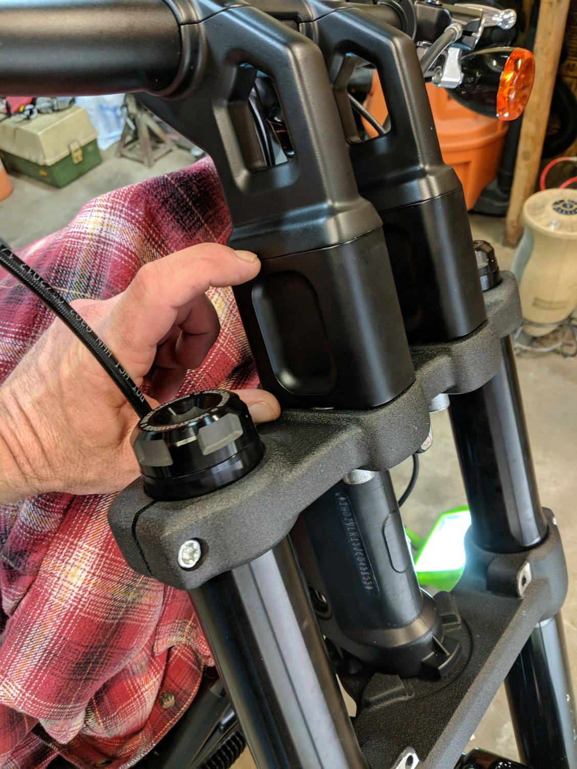

Let me begin by saying I am posting this from my phone so if auto correct Jack's it up I apologize.
Got the 3" extensions from bitchin seat company, kinda pricey but very well made. Color is slightly off under the shop lights but pretty close in natural light.
It was raining when I got off work, couldn't ride and I had two hours before a school function (singing) for the six year old so I decided to start the install. To my surprise I finished and had time for a quick ride when the rain stopped, total install time was about 40 minutes. Snapped a couple of pics to share, decided to post while sitting through other classes/grades singing. 🙄
As I said, easy install. No issue with brake line, had to bend wire harness captures slightly (both left and right), needed the slack from wires under tank, moved top clutch cable keeper up higher on down tube so I could angle it back slightly.
I like where they put my arms and they allow me to straighten my back instead of being hunched over. An added benefit, I can see a little better with the mirrors. Will still probably replace the mirrors soon.
Excuse the messy work shop, many projects going on...
Stock risers
With extensions
Close up of extensions

They do look very good. Looking at that triple tree, it looks like you can’t use regular T-bars or risers, is that right?

Given the options I found to raise the bars and improve my comfort, the cost was not terrible. I like the stock bars but did not like any of the options for taller risers that would accommodate the 1.5" diameter bar. In fact the only rises that I felt would look right on this style of bike we're the Big Al's bubba clamp risers. Unfortunately they have a 1" clamping area so that meant new bars which is an added expense. The Big Al's risers are also 10" which would mean new cables and wire extensions too (another expense). Thought about having a set of spacers made and then coated which would have been a bit cheaper. This route would require me to remove the risers and leave them with the shop making the spacers if I wanted them to match the stock risers. Didn't really want the down time. I have not ridden since the fall of 2017 and I am really enjoying this bike so down time was not an option.
I debated the purchase for two weeks. Given the fact they match and required no down time I sucked it up and dropped the coin. Probably would have spent the money on something else anyway.
