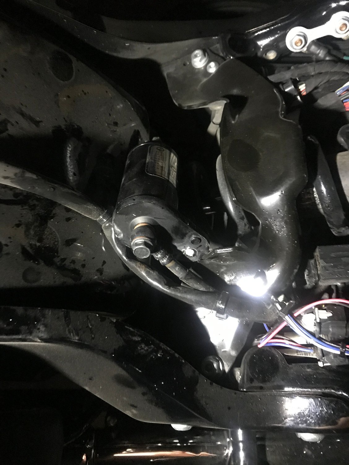

Has anyone out there had any issues with the rear shock, specifically the adjustment accumulator? I have 10500 miles on my 2018 Heritage, bought it in September 2018, and typically put on 75 miles a day to a from work. I have taken it on a couple of out of state trips on the way. This started when the left rear signal quit working. I worked my way up to the harness plugs under the seat, and discovered that the adjuster had broken off of the bracket (bolt head sheared), had fallen down and wedges between the rear of the mono shock and the front of the rear fender, severely bending the fender, and pushing on the harness hard enough that it unplugged the left rear. I hadn’t noticed any really unusual noise, and no noticeable change in ride. I haven’t hit any potholes or rough bridge transitions, although the HE Bailey turnpike I run a lot in Oklahoma is quite rough in places. The bike is at the dealer, scheduled to be looked at tomorrow. They initially tell me it will be warranty work, and should be, although I’m curious to see how they handle the damaged fender. Anyone else had similar issues out there?

Yours is the third or fourth one I've read about here. I wonder if the bolt was over torqued at the factory?

I’m not sure about the bolt being over torqued, although that is definitely a possibility. The bolt is sheared just below the head, right where the threads start. I’m thinking maybe it needs some added support out there on the open end, since all of the weight of the adjuster is hanging out there on a single bolt. This is the only issue whatsoever I’ve had with this bike, and I love it, ride the wheels ( and the rear preload adjuster) off of it.
