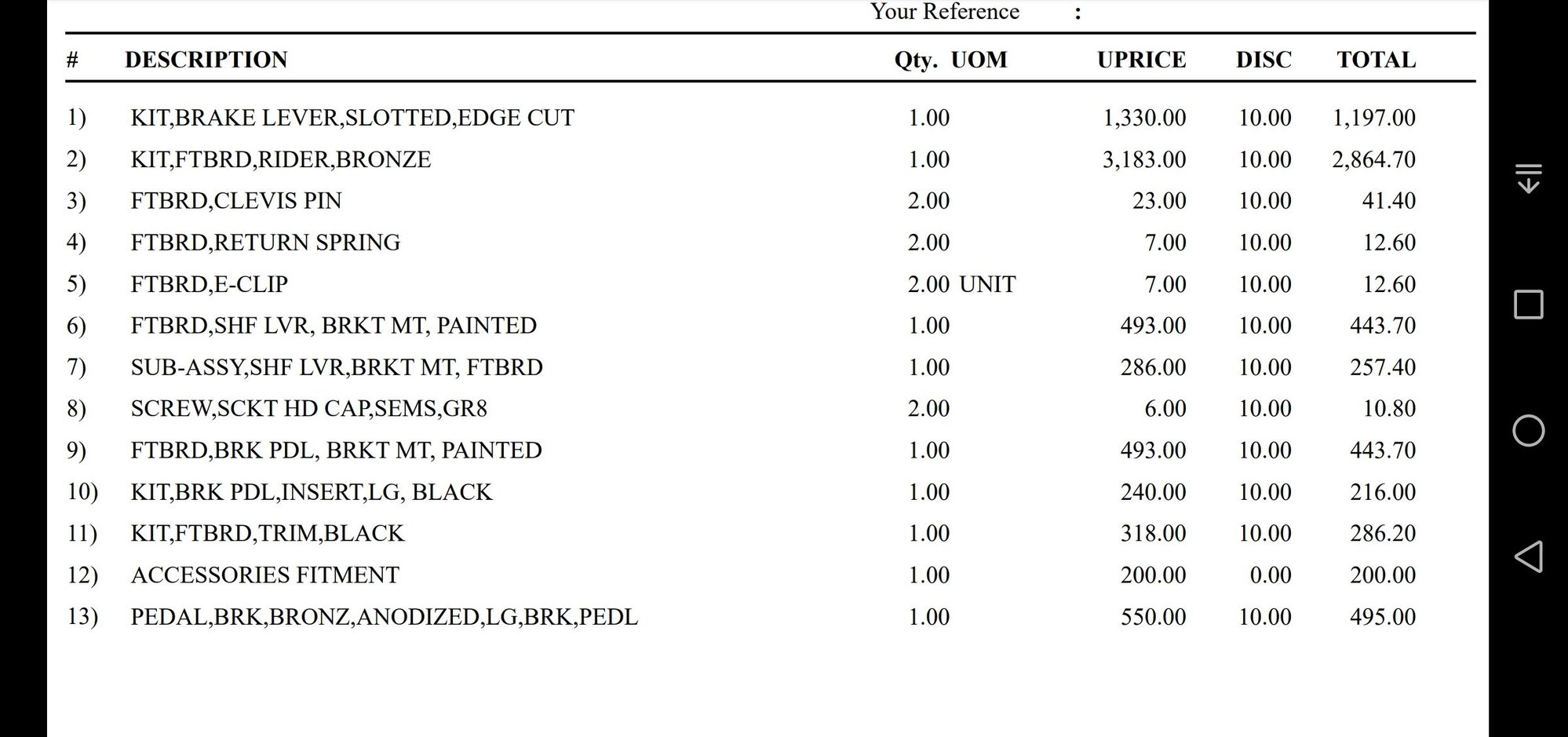

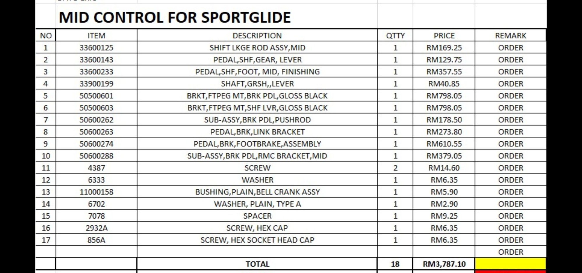

I had considered this but it seems like there a lot of work to do.... Including drilling a hole into the primary cover to mount the lever. Decided to just convert my foot peg to floor boards using fat boy parts. 30mins labour and I'm happy with my decision.
parts for floor board conversion. Do take note, I opt for dominion parts... Hence parts differs a little bit.
