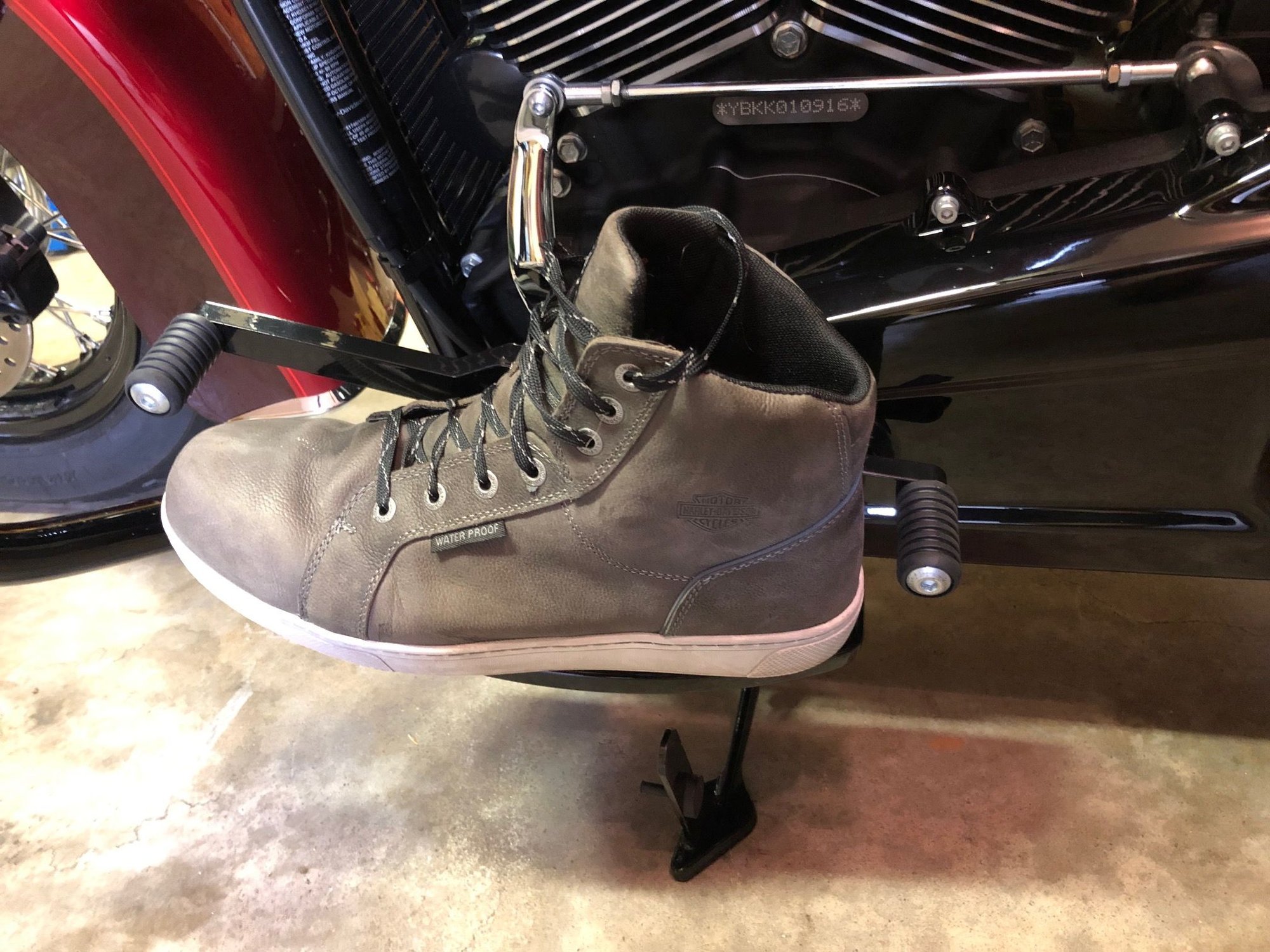

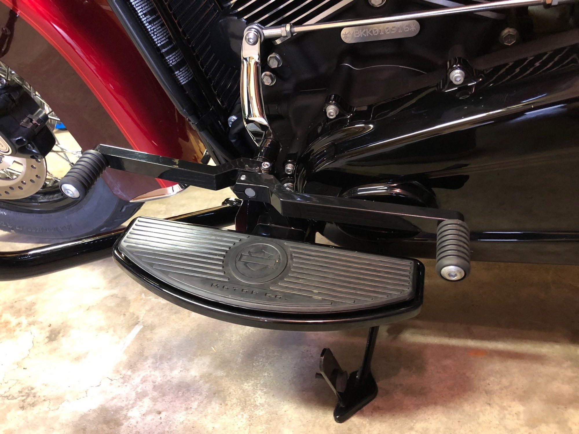

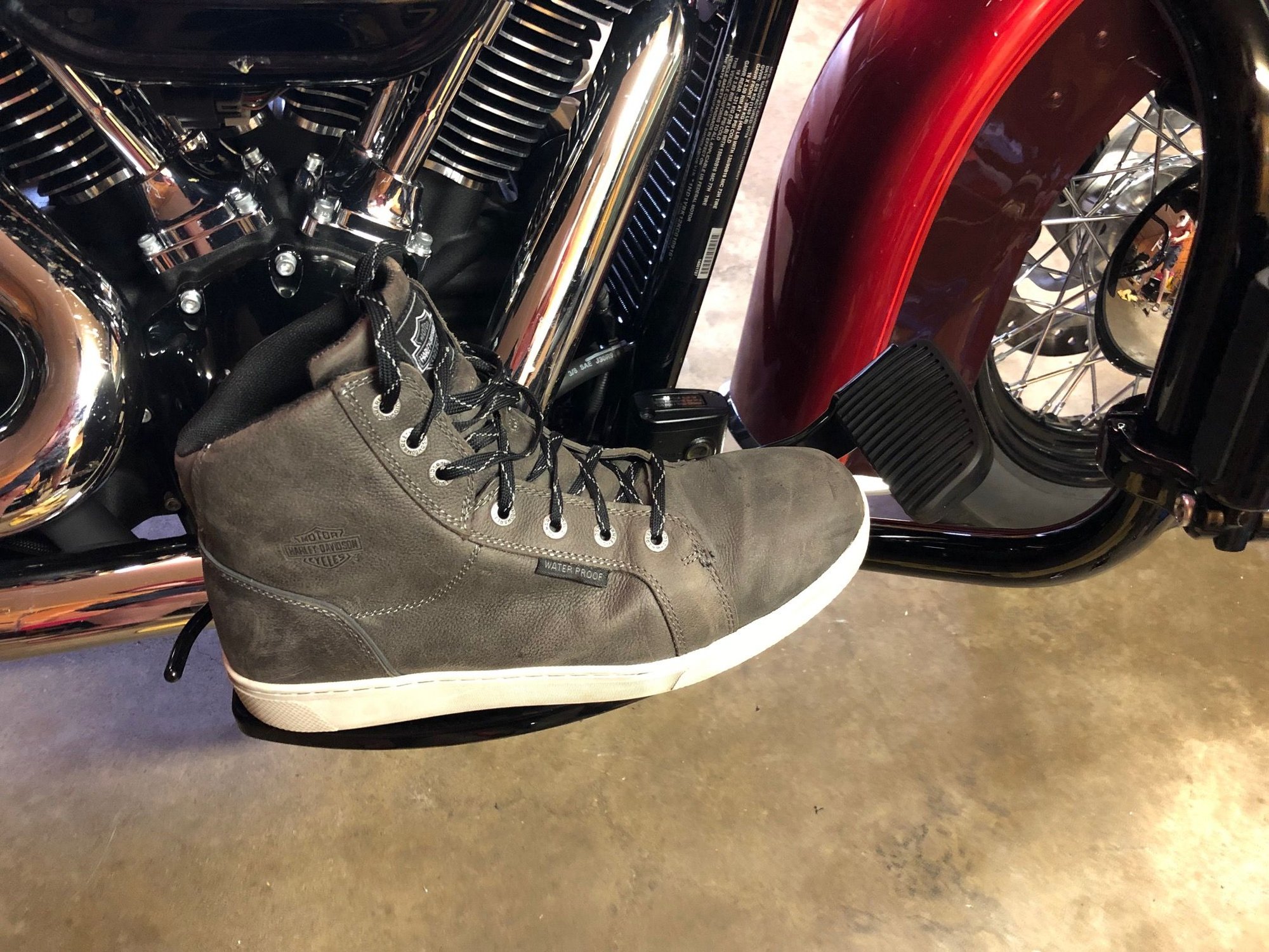

I also have a '19 Heritage. I needed to make the foot controls work with size 11.5 riding shoes. H-D never gets this right for me. I have long enough legs to reach the footboards easily.
I added a Softbrake +1 brake lever and a Heelguard to the right side.
On the left side I added the H-D heel shift kit and Softbrake extended levers (+0.5" for the toe and +1.5" for the heel).
Here's some pics showing how this works out.
