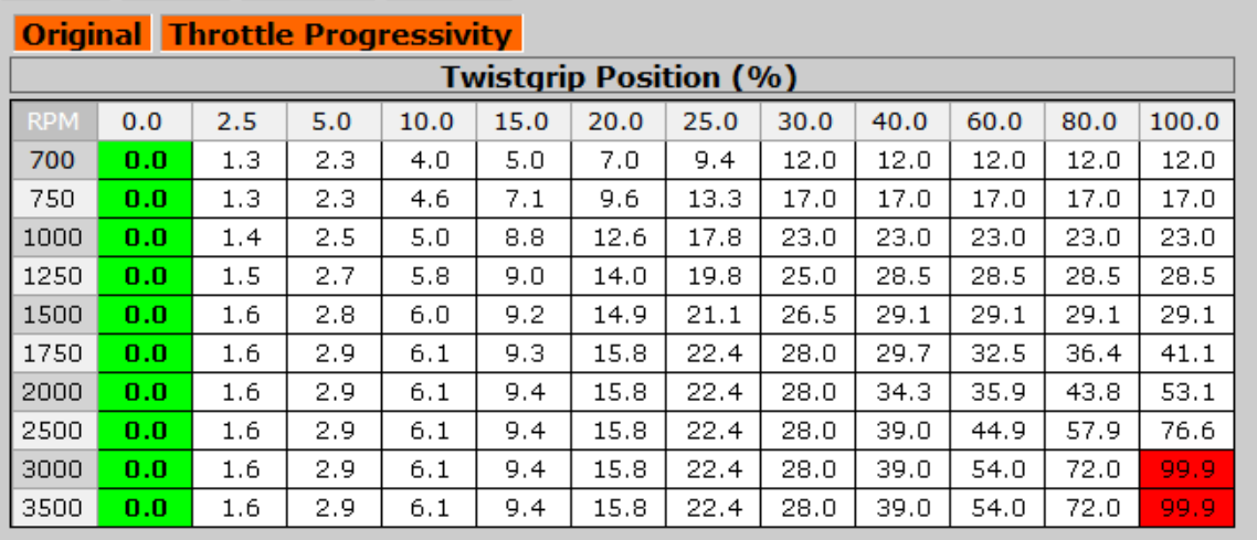

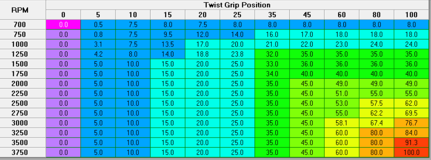

Originally Posted by Thingfish
The TBW lag can be adjusted/removed with a tuner.
There is no throttle lag to speak of, there is a programmed progressivity of the twist grip % rotation to throttle plate % open. From the H-D street tuner.
Here is a quote from Steve Cole explaining it:
One must first understand that there is no reason to open the throttle blade any further than you need to reach atmospheric pressure. Once the MAP is equal to atmospheric (Baro) pressure there is nothing more to be gained and even some to be lost! So if you could hold your engine at a fixed RPM and increase the throttle until you reach Baro with the MAP that's all you need at that RPM. That value would be the max you wanted at the 100% Twist Grip Position. Now if you make it one to one you can screw up the idle and the idle follower circuit as well so one needs to be careful. Another got ya is when trying to ride slow in parking lots for example you can make the throttle too jumpy or on a slow bumpy road you can get the same issue. Now once you get past all that you have to worry about the cruise control if equipped for smoothness of operation.
So there is a little more to it than meets the eye at first glance and you need to be careful. Some think it will help throttle response but when using TTS base calibrations we have found that most that have an issue with throttle response do not have the low throttle area tuned properly. Once properly tuned any perceived issue was gone. So my feeling is too many use it as a crutch for a poor low speed tune up.
No, it can cause the engine not to return to idle properly when you let off and cause the idle to hunt up and down. If your going to mess with it I would leave everything below 5% alone. It's just not as simple as some would like it to be and if you do a test you can determine that there is no reason for it to go to 100% at anything below 2500 RPM unless the engine is so big that the throttle body is way to small.
Here's how it is set in a TTS tune for a stock 107.

Yes a much better and more in depth answer than I gave.
I’ve had the good fortune to meet and talk to Steve. He certainly knows his stuff.

Regarding the tuner and throttle lag, I realize why it happens, I still don't like it. The feel of not being 100% in control of the bike just doesn't sit well with me.
