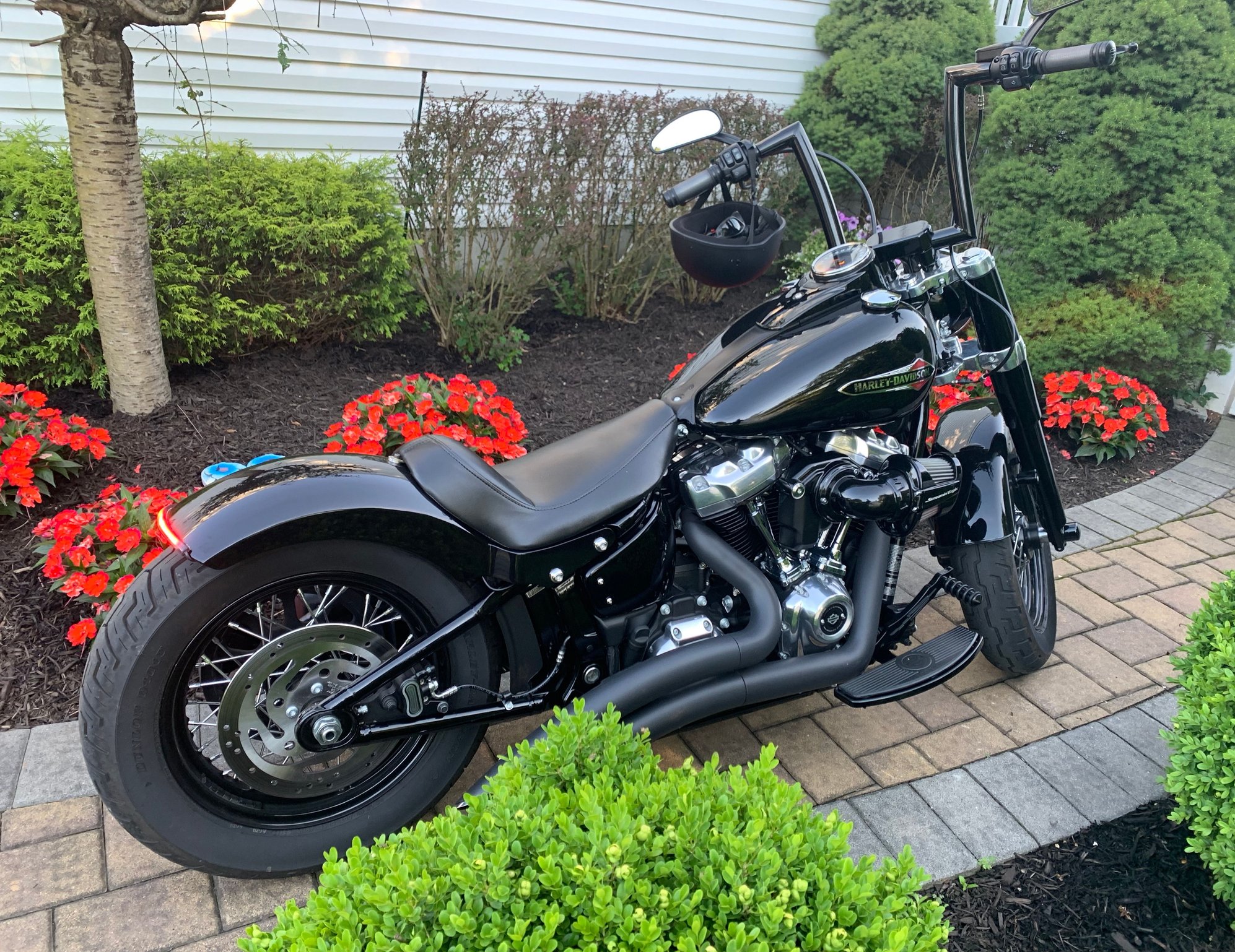

I was also looking to swap out my rear fender a couple of months ago. My local HD dealer looked into it and got back to me with it won't fit (different frame) I decided to go with the rick's 200er rear fender kit with seat pan. Definitely happy with the quality!! Before the install I swapped out the shock to lower the bike 2in. The fender brought the backend down even lower. Im very happy with the look, now to find the right rear wheel.
