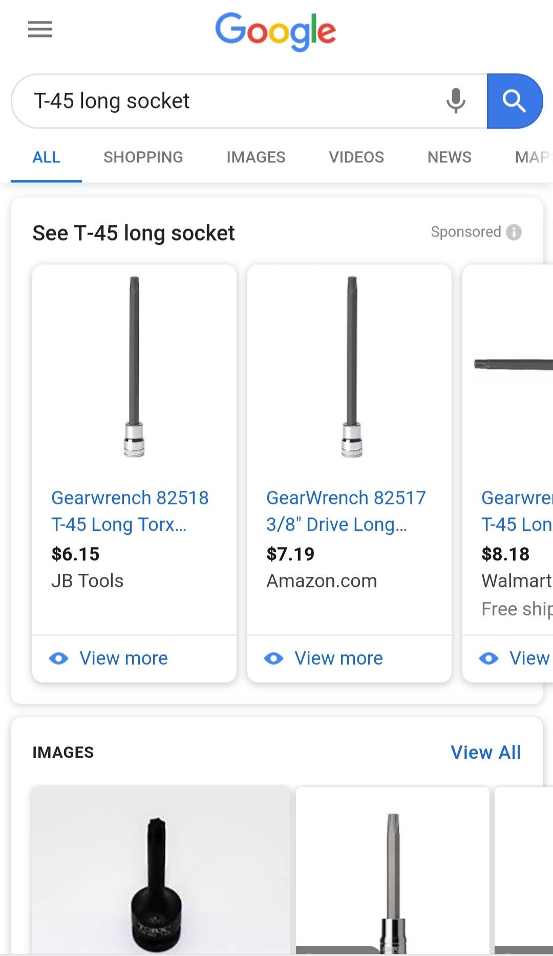

Google search brings up a ton of options. Harbor Freight has some as well. Not the greatest best brand name but are inexpensive and will do the job.
Edit: I thought I had got mine at Harbor freight but I now remember that they only had large sets which I didn't need. I ended up buying mine at Autozone because they had a set of 4 which were sizes I had a need for.
They are Duralast and are 3" long up to where the socket flares out and worked fine on my passenger peg mounts.

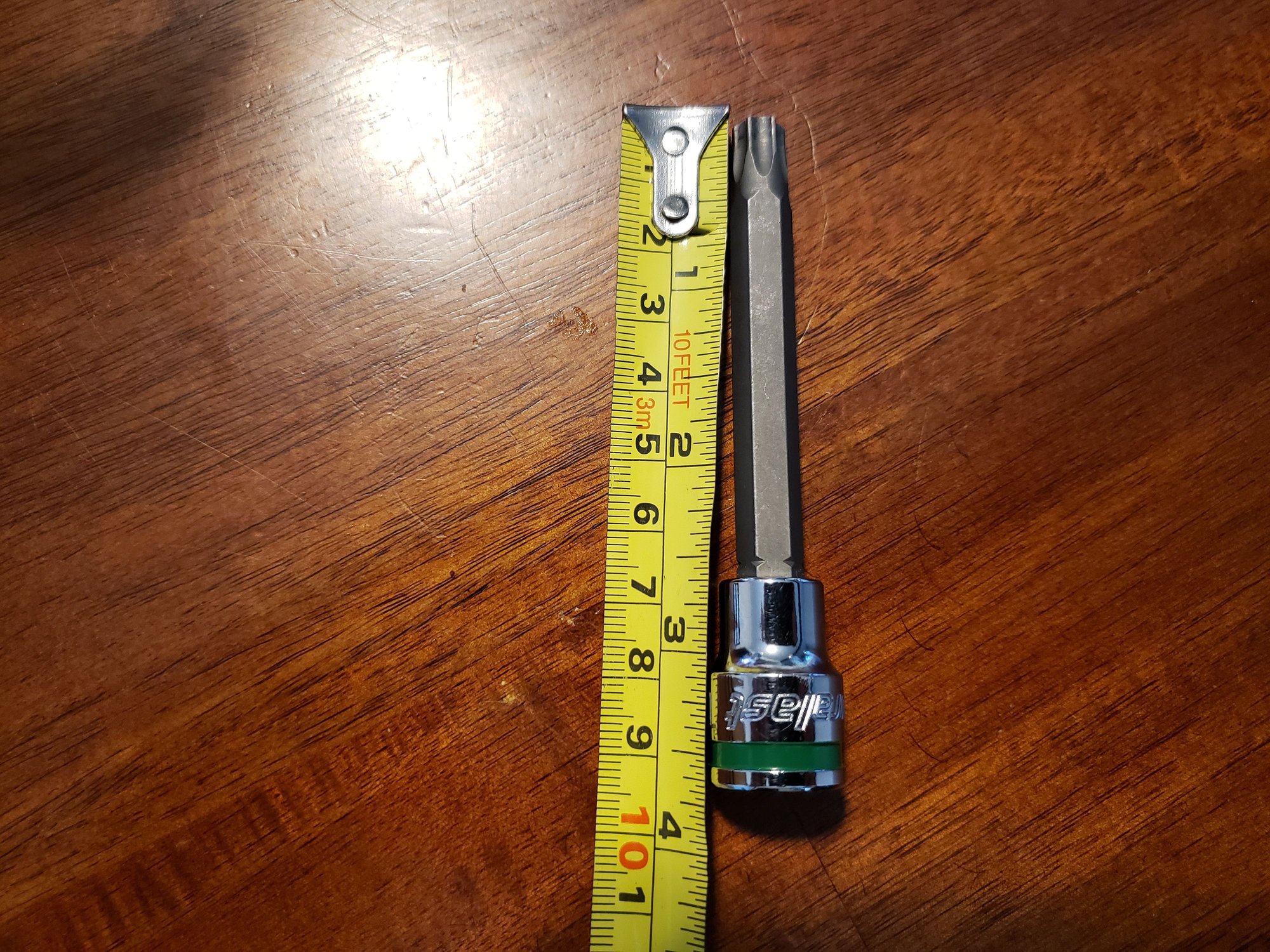

I knock the bit out of the socket and use it in a 1/4" drive, like this:
Good Idea! I would have done this but the only Torx sockets I had at the time are one solid piece.
