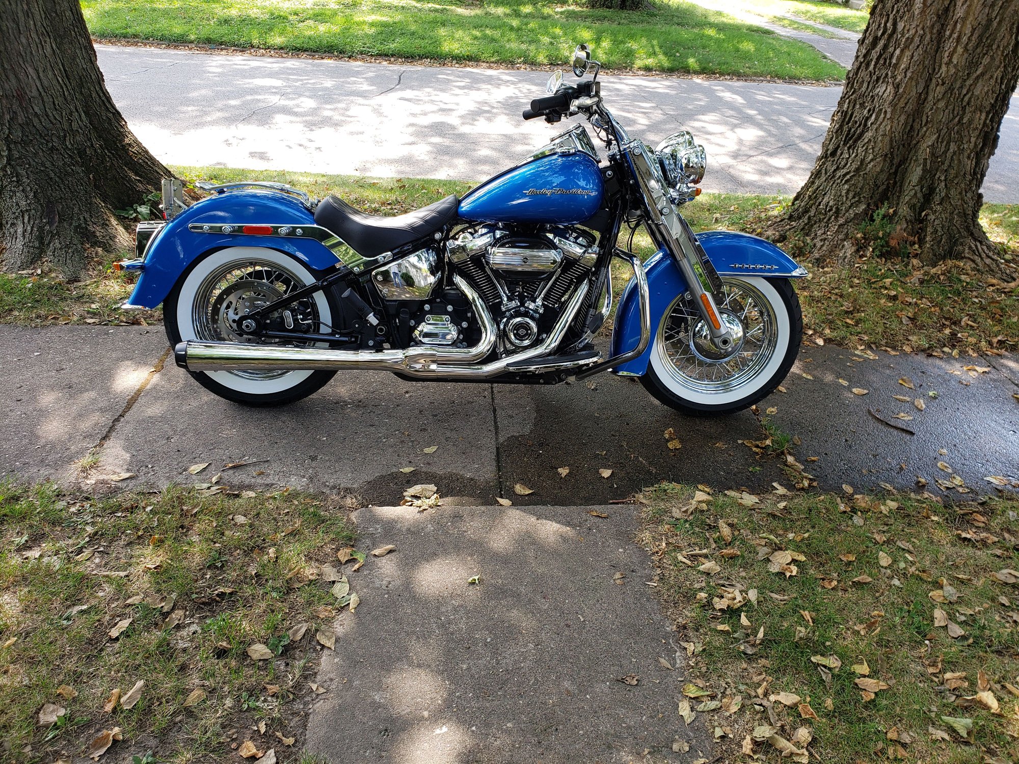

750 miles into the ‘19 Softail Deluxe with Ventilator intake and V&H Eliminator slip ons. Scream’n Eagle Street Turner and I know it is lean! I’m so tempted to throw the drive train warranty under the bus and put the FP3 Tuner on.
EPA (big government) she got me twisted! How many with the non touring M8 have taken the leap?
