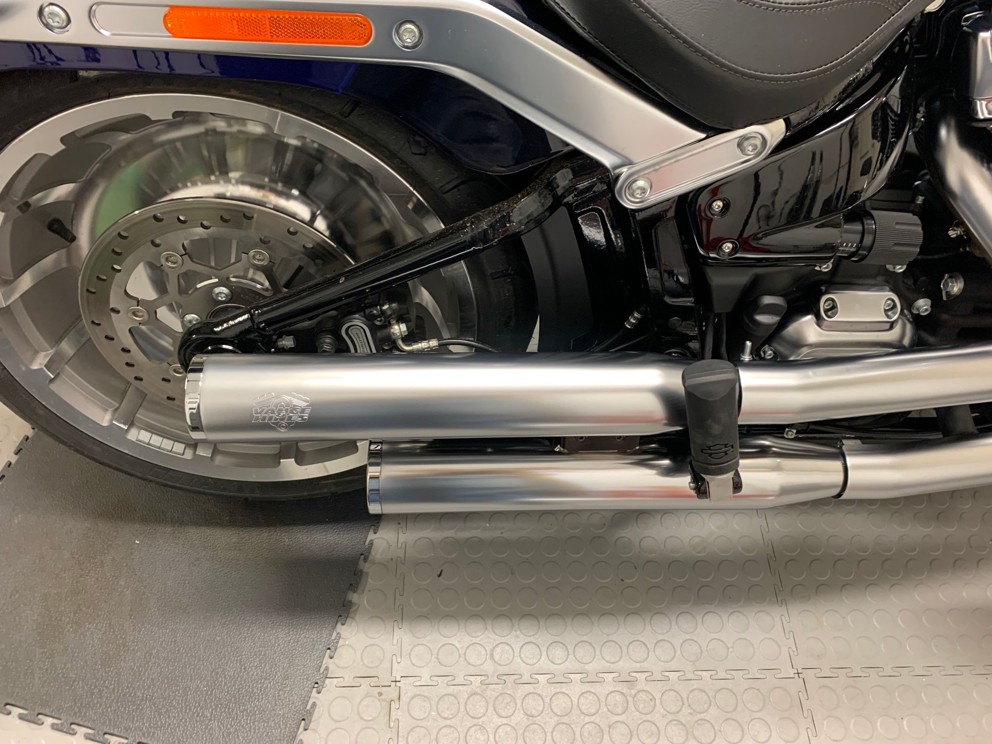

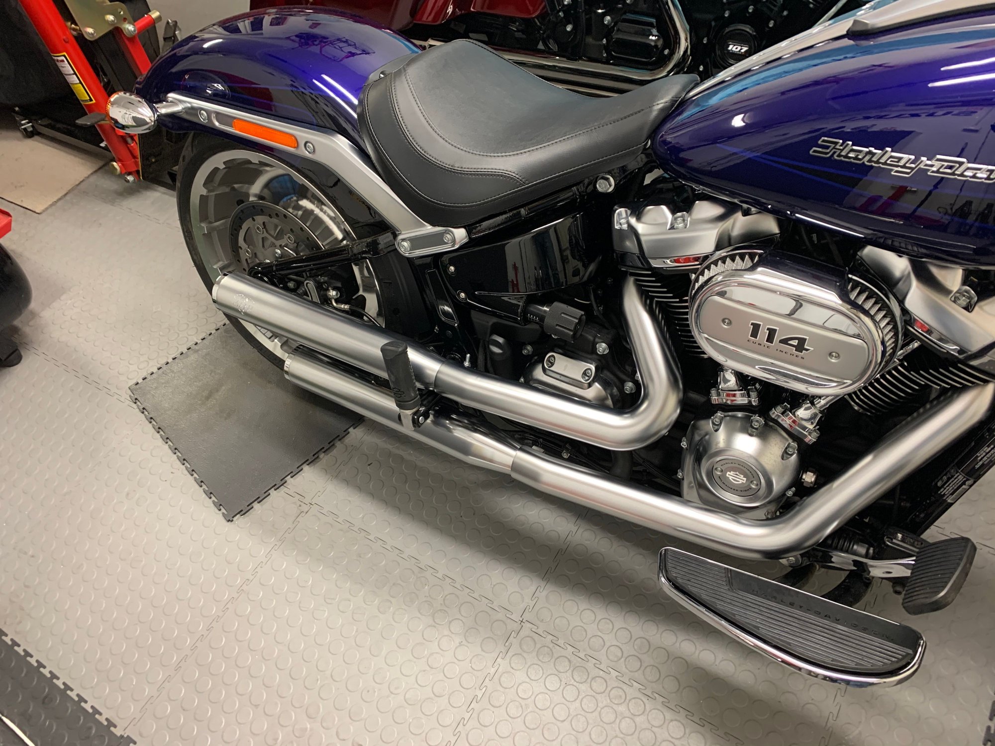

royston's Avatar
royston
Joined: Jan 2008
Posts: 715
Likes: 81
From: London, UK
Default Finished and installed
Better photo of the pipes installed - may put some black shrink wrap over the thread that is exposed on the top clamp.
