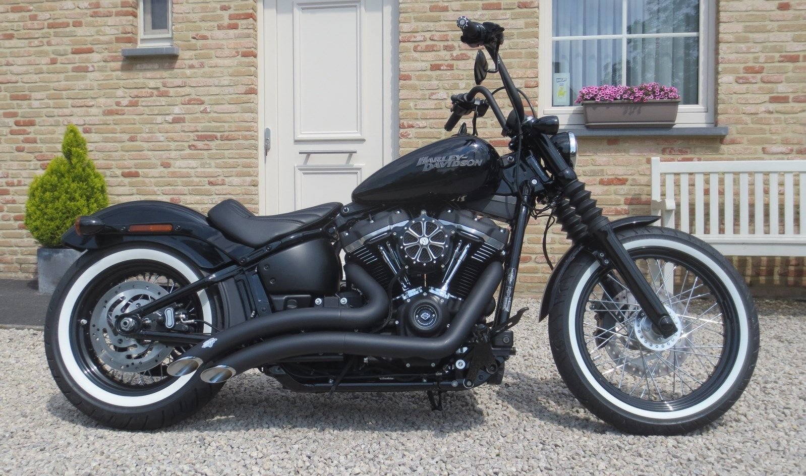

I have the V&H Big Radius and without any silencer it is loud as hell , keep in mind that my bike is lowered, so on a stock bike you have more ground clearance.
Those pipes really go well with the lines of the bike! does the exhaust come with silencers that are removable? Or is that something you had to cut or hack away?
They come with removable silencers.
