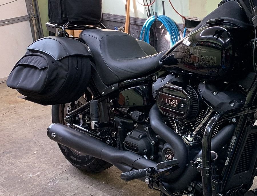

I installed a Fat Bob shock that has a convenient adjuster. I change settings depending on whether I'm using bags and a rack or not.
