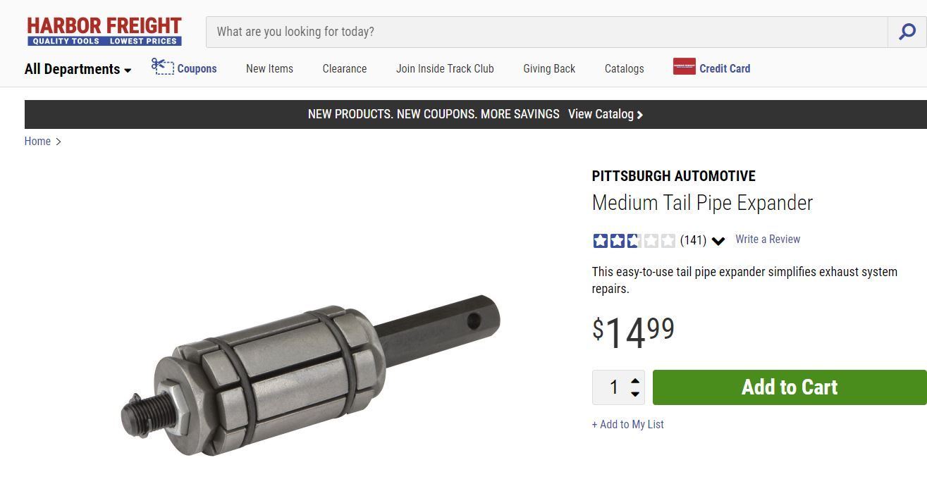

You might want to invest in a set of these, make sure you get the right size, saves a lot swearing, sweat & bashing with mallets...
I believe you can get them in the US in Harbour Freight or places like that at not much cost!
eght over there and other Auto stores>

might be worth a try

I have a set of three expanders and unfortunately, whilst they are usually great for this, I couldn’t get it to expand the tight section of the top muffler.
An inch or so of the opening was ok, it was right inside the flange almost where it joins the muffler body that was too tight and I couldn’t get it to open up.
