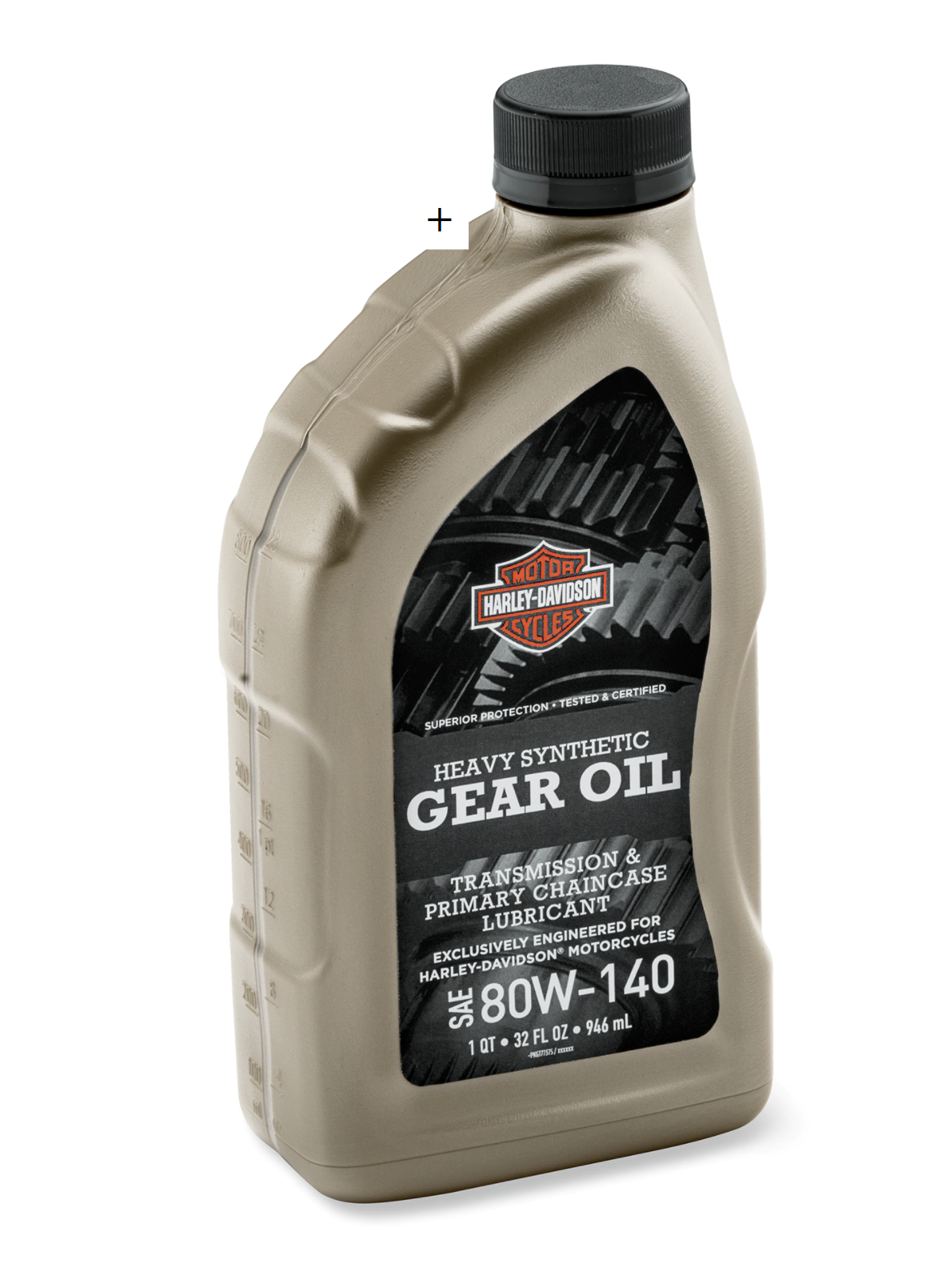

Formula + from H-D is on the thin side is made more for use in the primary. Since you are concerned, try a quart of the new H-D heavy synthetic gear oil. I bet it gets quieter.
I've used that and it works fine. I'm currently using Bel-Ray 85-140 gear oil and that also works great for me.
