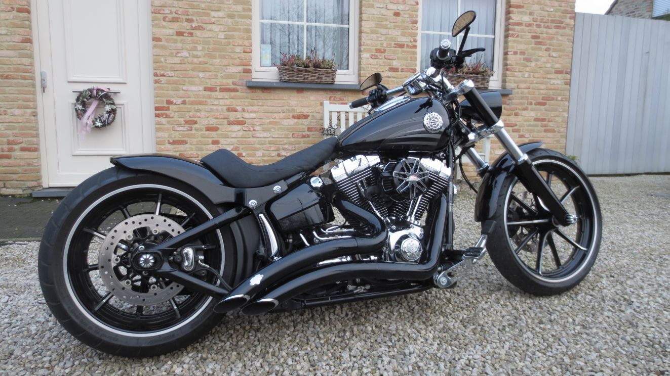

I have the SAS air ride on my 2016 Breakout but the new M8 platform uses a different shock, I'm now in the process of lowering a 2019 FXBB with the pPlatinum Air Suspension kit.
This is the platinum for the FXBB and will fit all the M8 softails

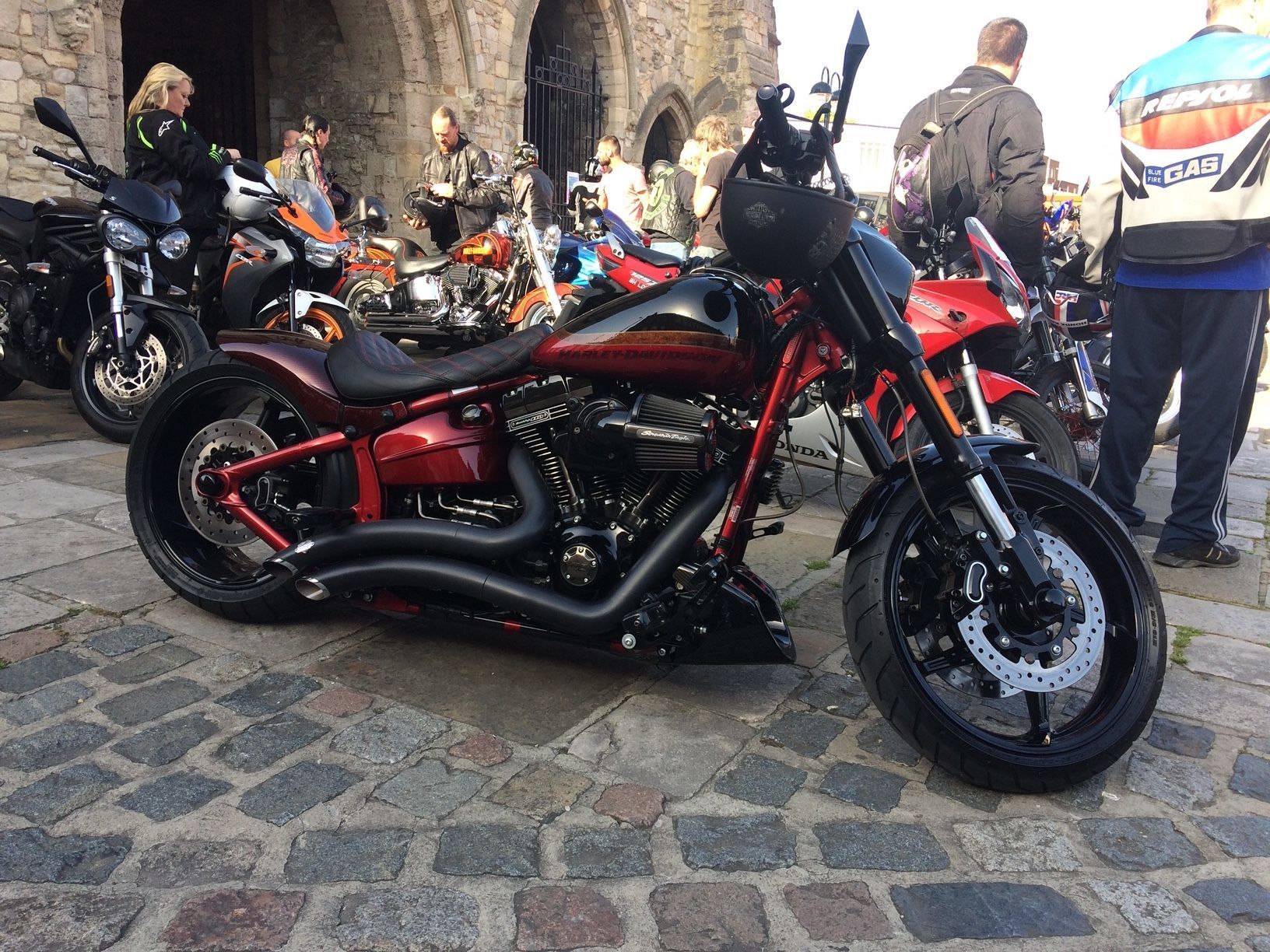

I dont want to go mad low. If I may ask, this is the rear fender I want on my bike
do you think this has been lowered. I do not mind this kind of gap.

The crappy weather means spanner time to get the bike as you wish. I did all my modifications at home. That has not been lowered by the looks of things and a view from the back as thought reveals an under fender aperture as large as the entrance to the Channel Tunnel. Same as MoneyFor I went for the fender with the running/stop and indicator lights built in. In fact he helped me with photos of his own seat so I could get mine custom made over here! Thanks again MoneyFor!

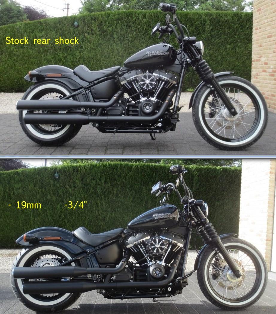

This is my FXBB now, it is lowered at the max for the big radius ( not on the picture ) exhaust, it is scraping already now. For that reason I bought air so I can get low
wen possible and higher for comfort riding.

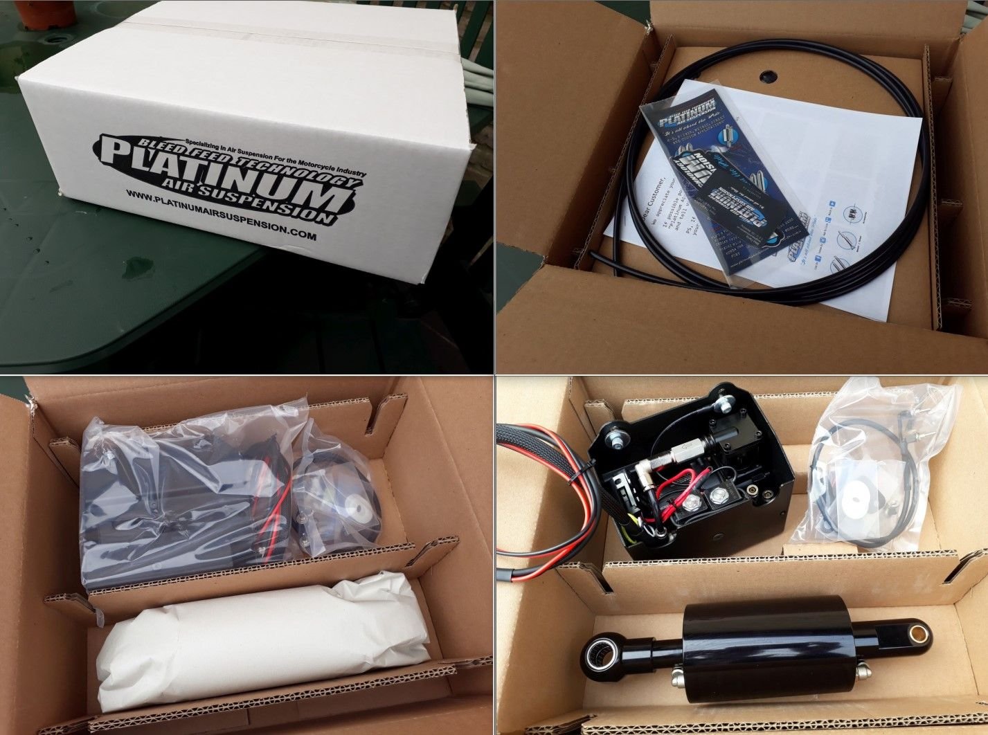

I already put here on the operating table last night, today I am starting the installation of the air suspension.....
