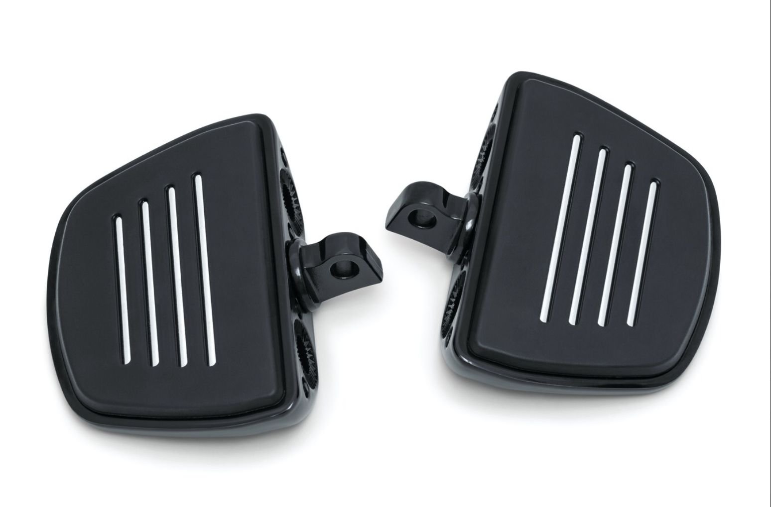

I went with these, had to adjust my shift lever but they work great for $120
https://www.kuryakyn.com/products/42...um-mini-boards

I cant find the dimensions on there site. Looks like about 4" X 6" ??? . Did you need a separate adapter or is it plug and play? Do you have trouble with the wind trying to lift your foot up at highway speeds? 😊
