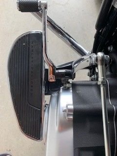

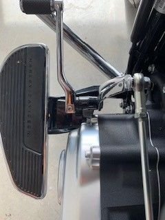

OZ Gary has a great picture with the spacers installed. If you don't have the spacer for the shift linkage, the shift rod will be on an angle, not straight. Notice the space in the 2nd picture between the floorboard and the primary. Now image the shift rod moved over to the left that much.
I bought the Kuryakyn set and had a spacer made for the shift linkage. And yes, the floorboard spacers made a big difference for me. Well worth it.

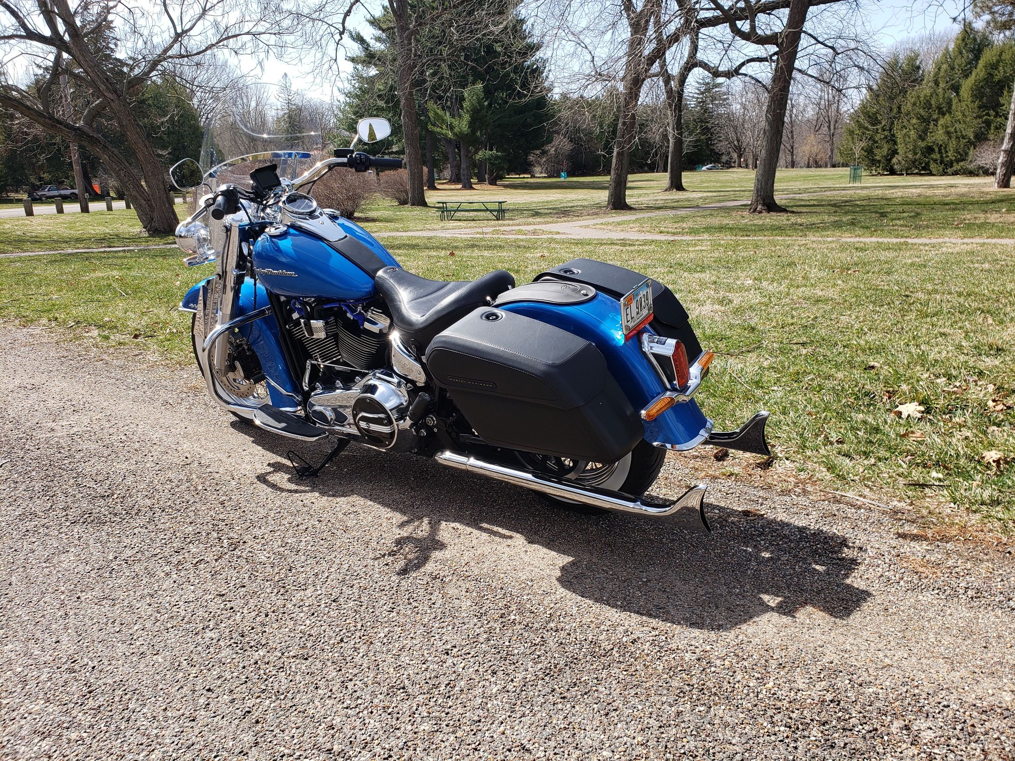

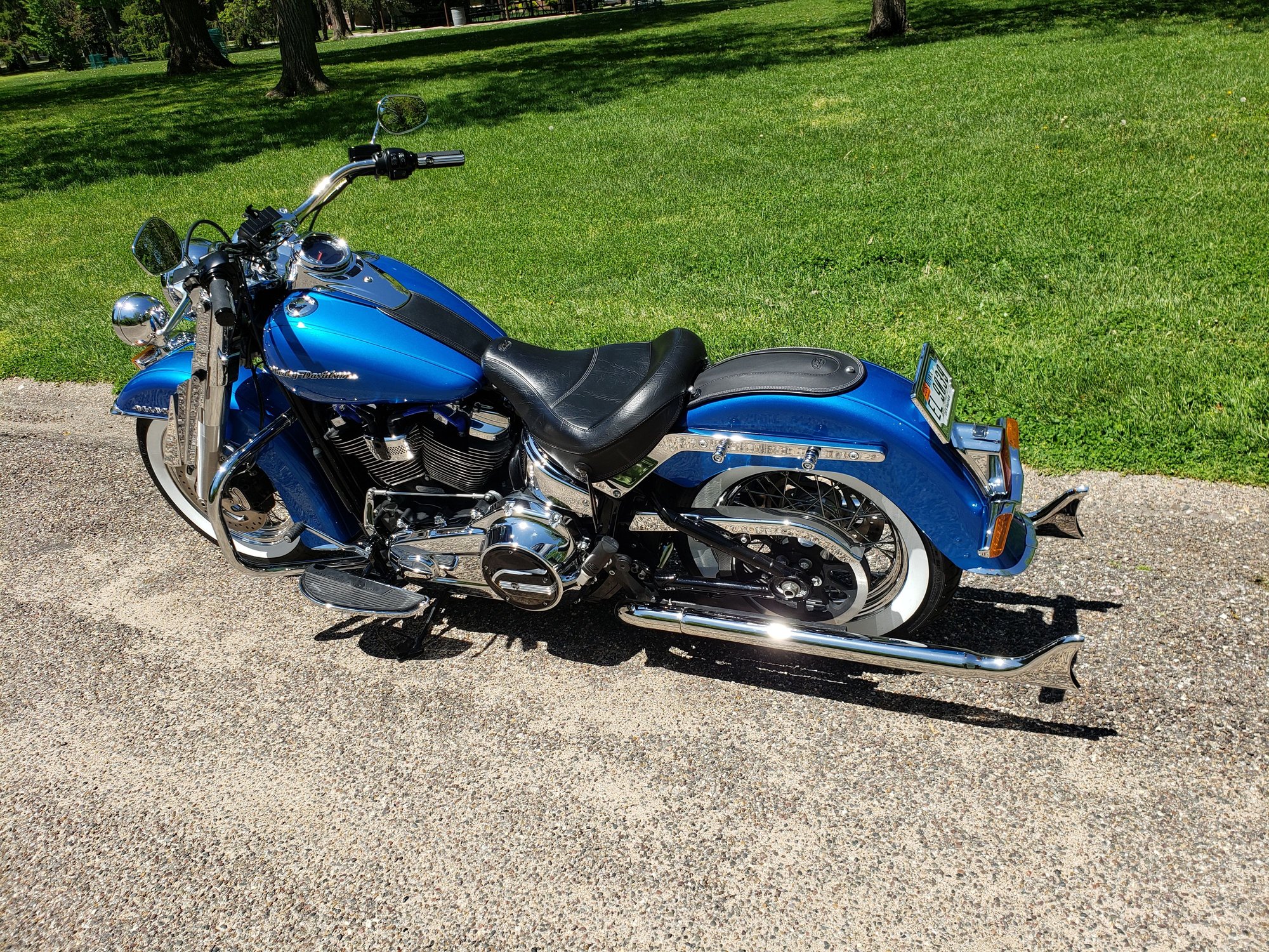

Here are some pics of my 2018 Deluxe using the Kuryakn spacer kit:
After install
after install, zoom in on it
Before install, zoom in and compare to other shot.

Certainly not knocking the Kuryakn set up but with the DK set up the linkage arm runs truer to std and not on an angle. Just an observation and it probably does not change the function of gear changing
