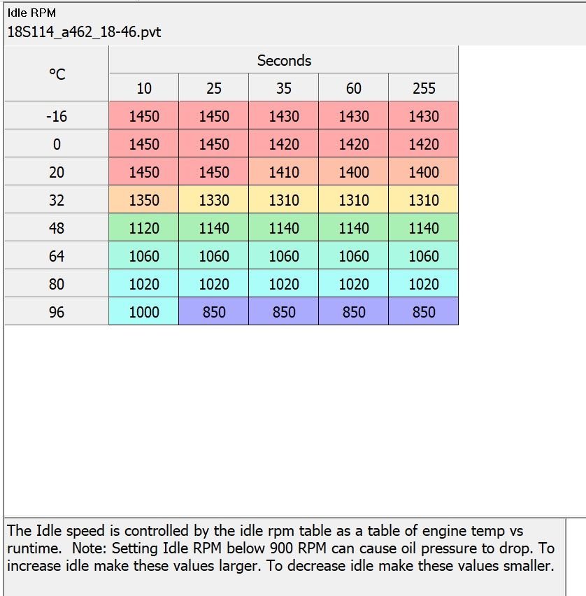

the idle speed table looks like this in the PV
Aftermarket is likely to change those 850s to 950 and adds a bit to the 64 and 80 rows to blend that in. I have mine set at 900 but that's a personal choice.
your while still moving question however, involves other factors, that I'm not sure are in a table anywhere you can see ?? don't know
