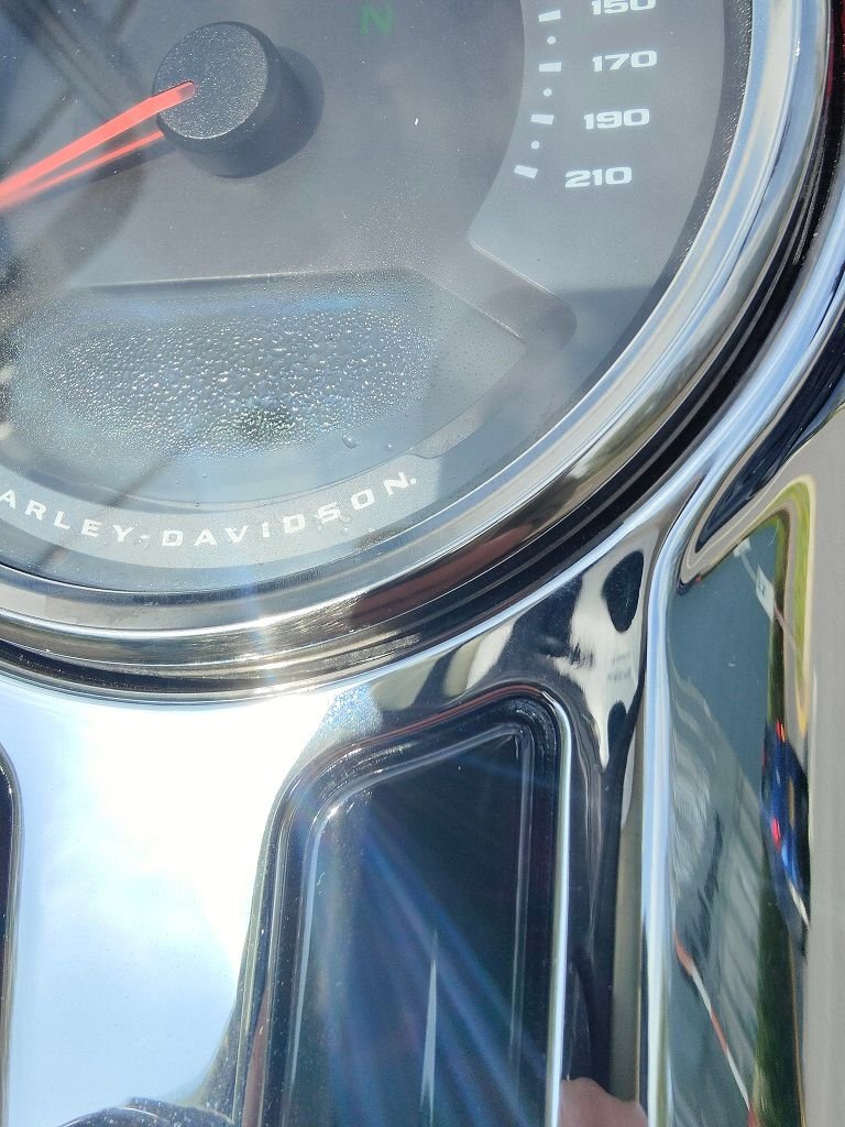

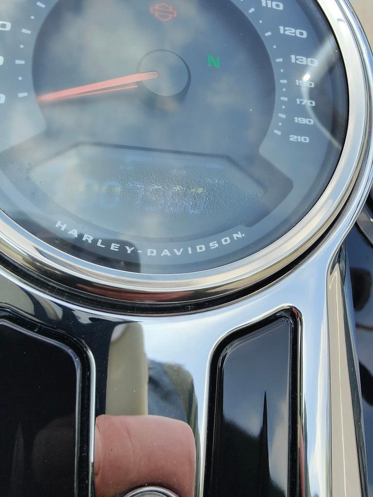

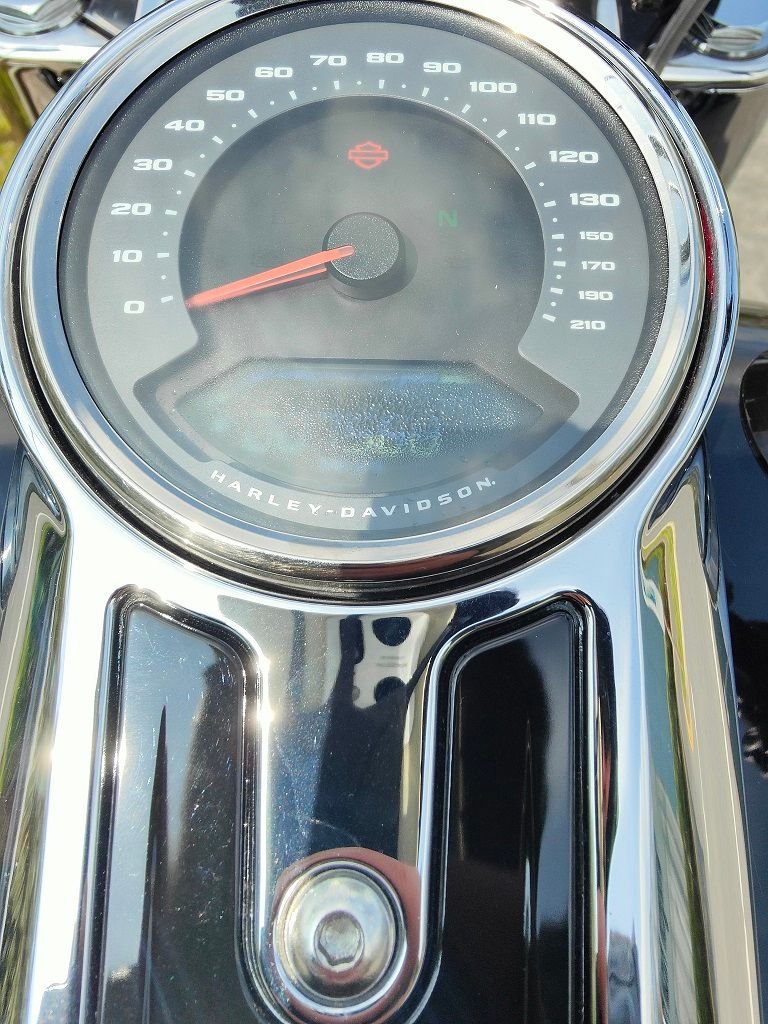

Originally Posted by Urban Gorilla
6 months on from my post and it happened again (04/29)
This time I took pictures to pass onto the dealer who are dragging their heels on this one!
I very much get the impression that HD are going to call this water ingress and thus NOT fix it under warranty.
(I've also had this response from another Dealership).
NOT F***ING IMPRESSED!
sad truth they cant fix it as all these speedos are faulty from factory. They can install new one and same $hit will happen but yours is extreme case for real. I guess it was raining when they manufactured yours so it caught more mousture than the rest. Try to get dealer to replace it but you will most likely get this resolved by drilling holes after warranty will expire. Shame on HD
