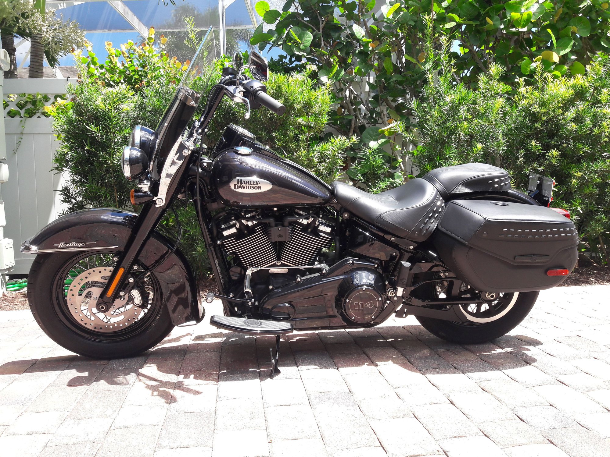

Old Jul 8, 2025 | 08:25 AM
TeeJayEe's Avatar
TeeJayEe
Joined: Aug 2016
Posts: 415
Likes: 125
From: London, England
Originally Posted by Uncle G.
I used handlebars from a 2018/19 Low Rider, part number 55800693. No wiring or cable changes were needed.
Revisiting this thread as I just ordered the Lowrider bars to put on my Heritage. They look great on yours.
Were you able to just leave the clutch/brake lines attached while swapping? I’m guessing since the cables all remain the same length I can just unplug electrical cables and reroute them through the bars and leave the brake/clutch alone.
The workshop manual says to remove brake/clutch line but I’m guessing that’s just standard practice and only needed where different lengths are needed.
