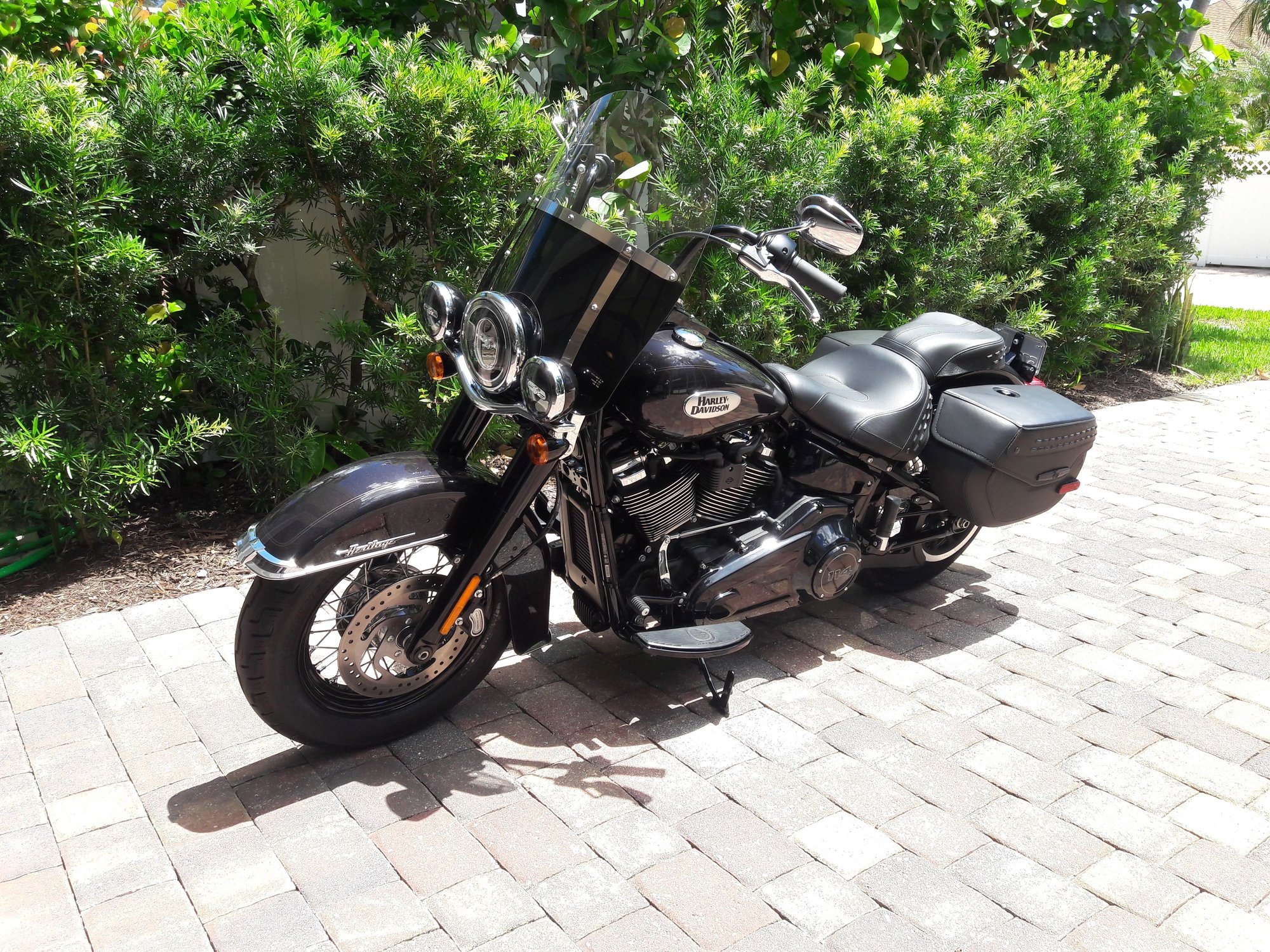

Default STRANGE Squeal
Will send audio clip of mine so you can compare. Same machine,
took delivery 2 weeks ago. 2021 Heritage 114 450 miles.
