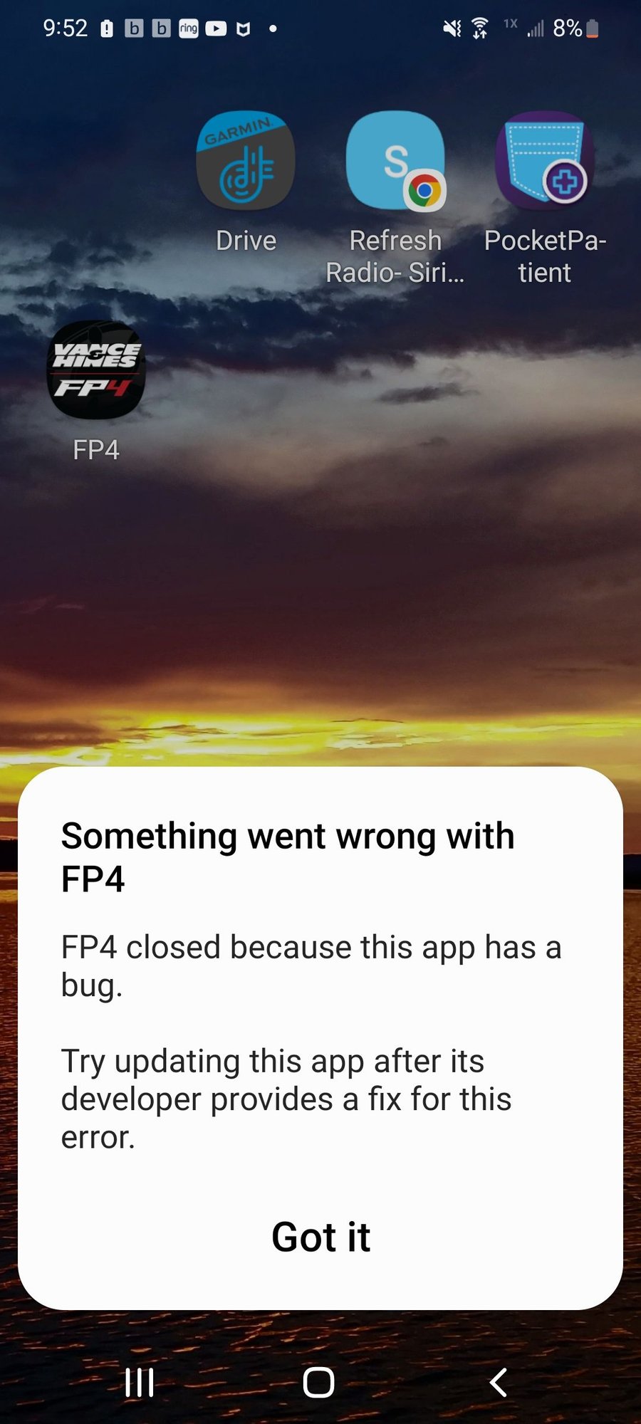

Restarted phone. Cleared phone and app cache, deleted app and reinstalled. Using Android

Crap, I don't know man.. the android version is supposed to be the more functional, working version of the two.
Right now all your fuel cells are set to 14.6.. so you definitely gotta get it back to a regular map. Do you know anyone with an iPhone, just so you can try using the app that way?
I would call their tech support, see if maybe they have an idea. When it happened to me (it put my bike into limp mode) they told me to pay for a tow home and mail them the ecu. So I'm guessing maybe they will suggest the same if they can't get it working.
Worst case, you might have to send them the ecu, or you bite the bullet and bring it to Harley to reflash the ECU, wait until there is some update where it's working, or buy a different tuner to reflash it.
I'm crossing my fingers for you.. I'm hoping that their tech support can get it resolved.

Thanks . Im going to call them today and later try a iphone .

Ha! Called the number on the FP4 program and rings once and disconnects. Jesus i get myself in jams sometimes. 🤪🤪🤪

^ why not email the guy I mentioned above?
I also sent him this thread...see if they're fully aware of all these issues and whatnot. worth getting eyes on.
*edit and just like that within minutes, his reply:
"Yes. We are aware of this issue. I have been contacted by the guy posting the screenshots, username JLC2012FATBOYLO. He is good now tuning wise. I set him up with a tune.
It looks like the app is experiencing instability on some Androids. We have identified the problem. I was told by my Android app developer that there should be an update later today for Android. It has been submitted, just needs to be approved by the app store."

100% agree ⤴️ i havent had time to post follow up here but all afternoon I have been receiving emails and advice from Mathew and am very pleased with his support. So when I get done working today I will go back to try everything he suggested and the map he made for me. Very pleased with their response and help.
Not sure what was wrong with the phone this morning but maybe that's what it does when they are closed. I now realize that i was calling California from Connecticut at 8am this morning (5am their time). There and if it does not rain ... I will ride till I can't no more. 🤪

Just checked the playstore app and as promised there is a update to the app that addresses the auto tune for Android.
From app update,
WHATS NEW.
"With this new release, we have addressed a bug in Autotune. Thank you for choosing FP4 and for your patience. Please let us know if you have any further issues."
Tomorrow b4 work I will try it again.
