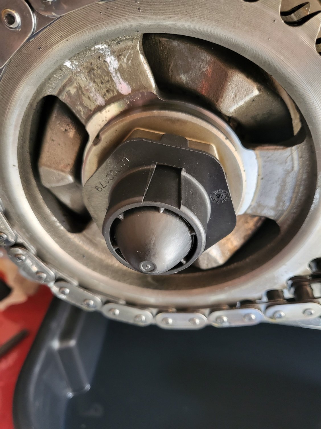

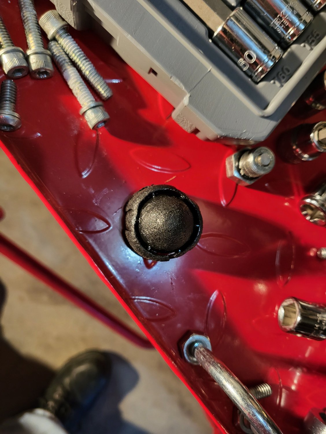

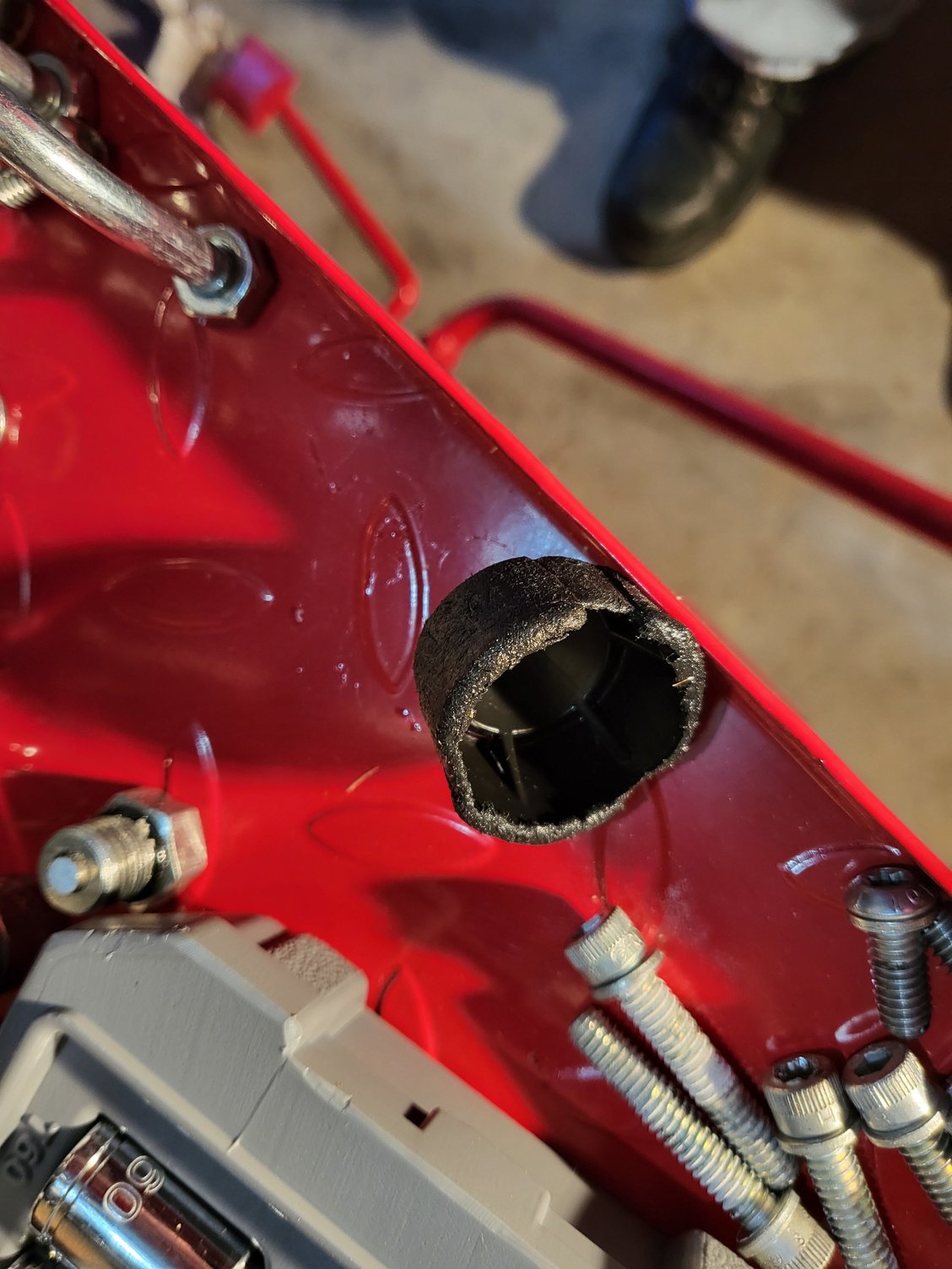

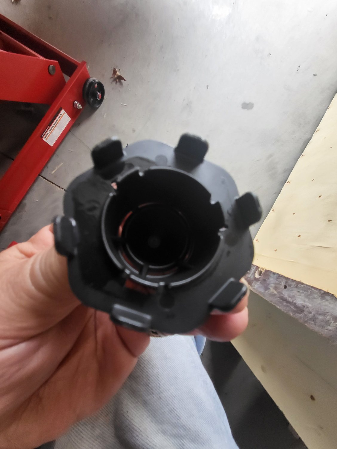

I did have something that you don't hear about. Earlier this year I started hearing a noise like something was dragging under the bike.
The more I listened and looked it sounded like it was coming from the primary. I put it up on the lift and dropped the rear wheel door, started it up and nothing.
After pulling the primary cover I found this chewed up dome looking thing. Somehow the oil spinner had become dislodge and was being thrown around inside of the primary.
