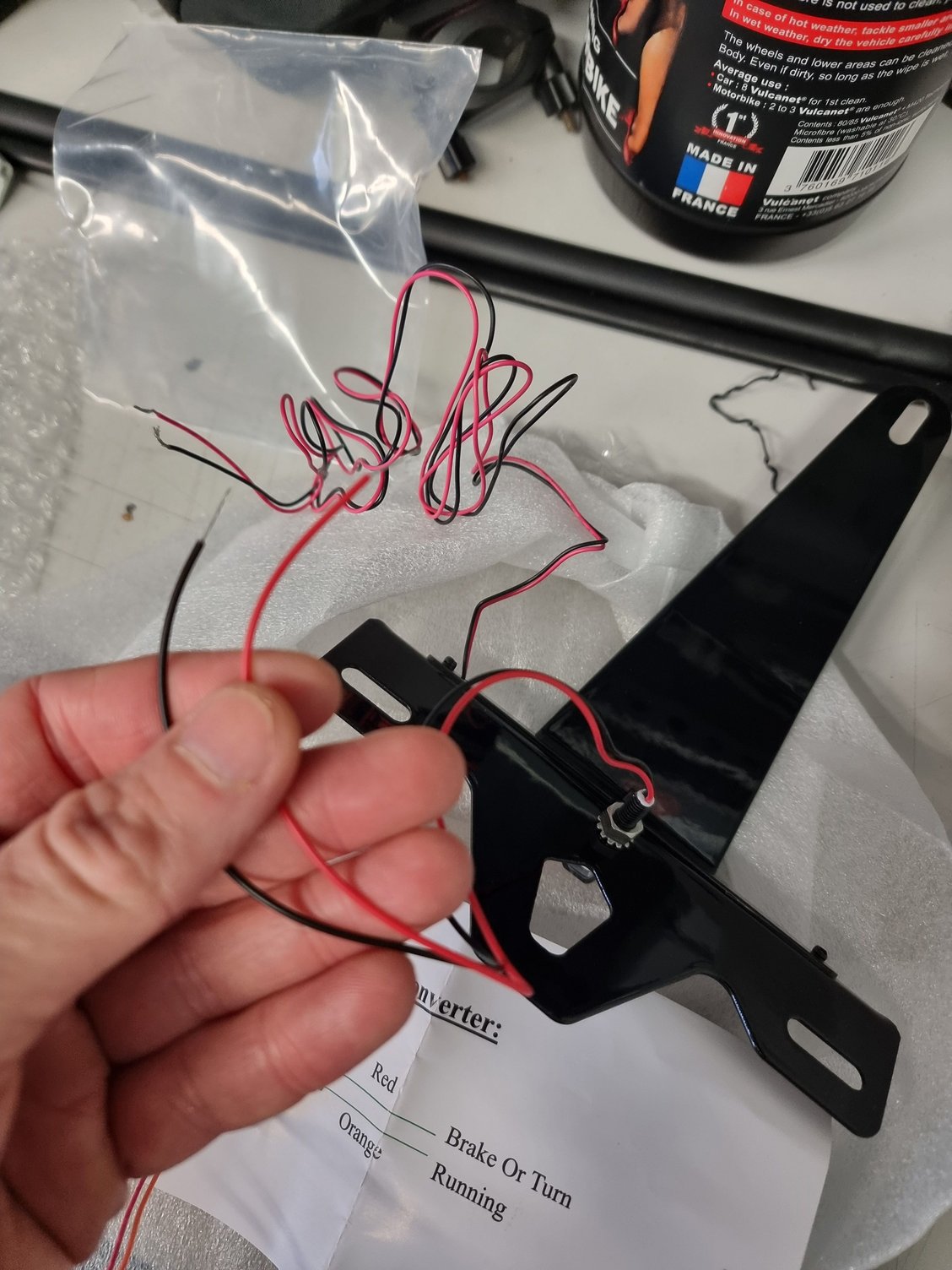

Hello men.Ive bought a Zeel design fender eliminator license plate and tail light kit.However it doesn't cone with a plug to connect into the loo.Id like to get the correct plug rather than splicing or soldering in Can you guys help with this one?

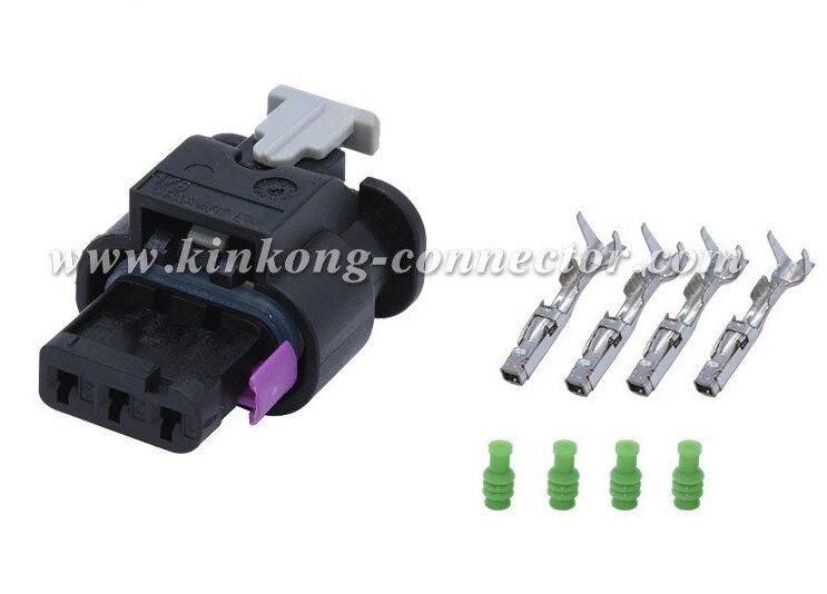

Under the seat on the right side near the back of the petrol tank you will find three connectors in a clip. One of them will look like this. This will currently have two black wires coming out of it one being an earth, the other is providing power to your number plate light
The female (loom) side of this connector will have three wires going into it. Blue = bike on, power on. Black = earth. Blue & Red = brake light power. Connect tail light to blue, brake to blue / red, earth to black. You will also need to splice whatever wire you have connected to the Blue for n. plate light power.
To buy the connector and sockets to avoid buggering up your OEM one see this chap in Northampton. Very helpful.

so that link to ebay with that Northampton guy is the connector needed ya?Also here's a pic of my tail tidy.2 wires for rear tail light+2 for licence plate light
