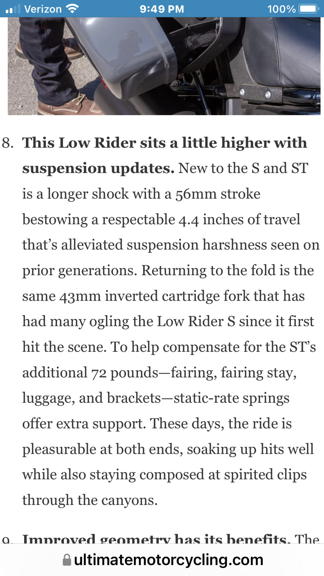

Originally Posted by Durham man
ng I wonder if the static springs that are in the st to manage the weight of the st fairing can be easily swapped to the standard s forks. I have no problems with the weight of my fairing as is but if I do the stereo thing I would want to beef up my front suspension. I have not heard alot of great reviews on going with the big name fork upgrade products to take that cash plunge.
