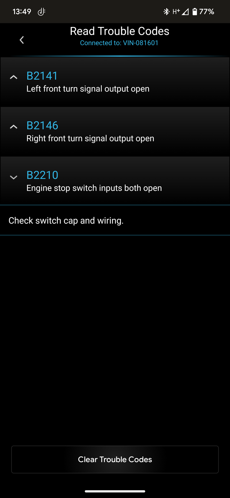

Originally Posted by feareg
So yesterday they called me that they couldn't replicate the issue, which is strange because that day I had it 4 times before I arrived there. Nevermind, today I went for the bike. A few kilometers from the dealership I had the error again so went back.
In the diagnostics menu I had a BCM error code, B2210h. They are going to order a new control unit and replace it, according to them will take about a month or so..
I had the same error a couple of months ago, my FP3 suggests it is down to the switchgear, which lines up as it only flagged after I used my hazard lights, it's been on here before too https://www.hdforums.com/forum/2018-...ror-b2210.html , Me I just cleared the code and haven't had it come back.
