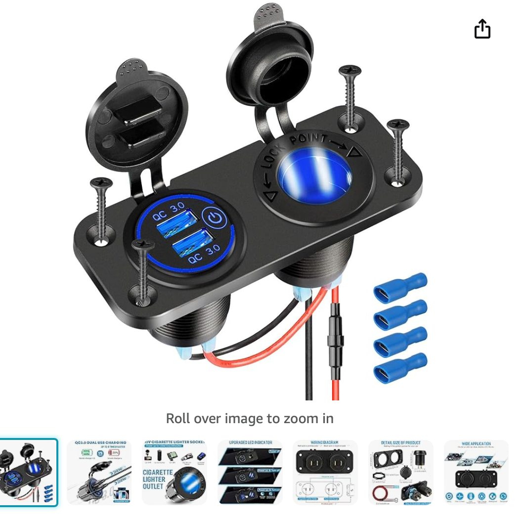

If the Garmin is 12V then something like this might work out. Might be a cleaner install somewhere near where the original is so not to clutter the handle bar areas.
[Upgraded] Cigarette Lighter Socket Outlet Splitter, Quick Charge 3.0 USB Charger Power Outlet with LED, 12V USB Outlet Marine Waterproof Power Panel Adapter DIY Kit for Car Boat Marine RV, etc
