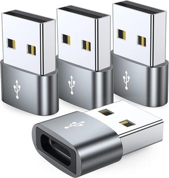

Just buy an adapter
Amazon Amazon
JXMOX USB C Female to USB Male Adapter 4-Pack, Type C to USB A Charger Cable
Or go the other way.
Amazon Amazon
USB C to USB Adapter, Type C Thunderbolt 4 OTG Converter, USB C Male to USB 3.0 Female Adapter (3-Pack)

Let me clarify. I'm after the increased power of a USB-C output port.
I'm well aware of using a converter cable, and will if I have to when the time arises. I already use a USB-A to Lightning cable.
But, I am disappointed in the very low power output of the existing Harley USB-A output. It barely keeps up with my current phone running just a single navigation app. Yes, this is with the same power cable I use on other bikes and cars with a USB-A power port. It's only with the Heritage that it has trouble staying charged up.
It's just an oddity, to me, that no one makes a drop-in USB-C replacement for these bikes. I was hoping perhaps someone here knew of one, as I haven't found one anywhere.
I suppose I will probably go with the Quadlock waterproof USB-C cable system instead.

This is solved by just buying a USB A to USB C cable. Done. Yes, you could get an adapter but now you have another point of failure and another point where moisture can get in.

Doesn't address the low power output of the OEM USB-A port on the bike. That's what I want to improve.
