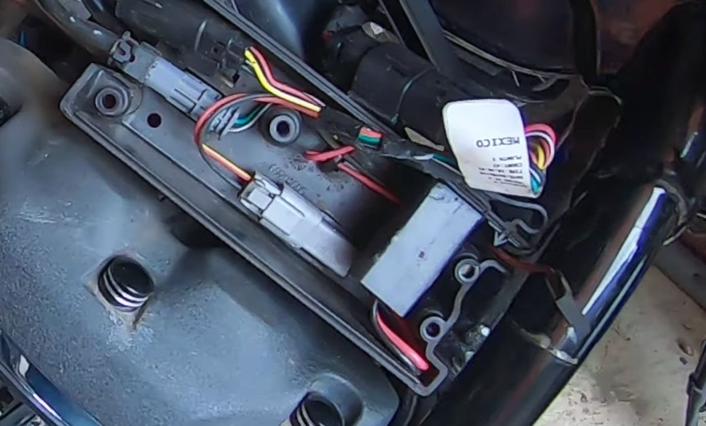

I rather like the notion of plugging into the accessory power circuit there in the USB box or module or whatever they call it.
For caution's sake, please check how that is fused. Maybe you will need to swap a larger fuse, if the circuitry will support it, or maybe running a higher-than-designed draw through there will pop one of the bikes few OEM fuses which could disable multiple circuits. Sorry, I don't remember it at that detail level.

Originally Posted by FatBob2018
Regarding the conversion: it looks like it'd be pretty simple. You just need a port and a place to mount it. Revelator Alf shows how to install the 69201750 cable which provides an open 12V connection in this video:
https://www.youtube.com/watch?v=SkcOSFl_kck
That's the cable I installed to power my heated grips; it was really simple to do. You would probably be able to get the full 36 watts of a normal USB-C on a 12V supply. You could mount a USB-C port on the handlebars or wherever else you want.
Alternatively, if you want to stay self-contained within the box under the tank, this is a shot of what it looks like, taken from the above video:
Now, it's rather spacious in there as-is. But if you install the electrical cable, it takes up a lot of that space. So I'm thinking if you wanted to replace the existing USB-A with a USB-C, you could just unplug the existing one and then either snip off the connector end and use those bare wires to wire in a new USB-C port, or (perhaps better yet) get the right connector and make your own. Reason I say that is Harley charges $85 for that USB-A assembly! Might be able to ebay that for $30 or so and cover your costs that way. Then get a dash-mounted USB-C and wire it to that new connector, plug it in, and then you have to cut a hole in the box to mount the new USB-C, or maybe try to fit it through the same hole as the USB-A port was in. Might require using a 3D Printer to print up an adapter plate so it fits snugly and waterproof.
Unless I missed something... thought the goal was to deliver more power via USB-C. Do those existing wires have the capacity for the increased load? Then there's the fuses...
