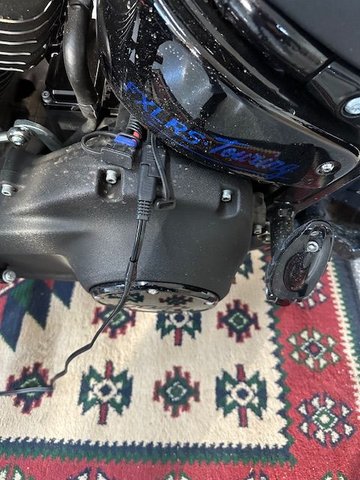

You can't use a battery maintainer pigtail for a jump box. The wires are not robust enough (heavy gauge) and the polarity will be reversed. My pigtail (Antigravity) exits under the left cover next to the one for the battery maintainer. Easy to plug in the jump box. Disregard the dirty bike, got caught in the rain, wash day this afternoon, LOL.

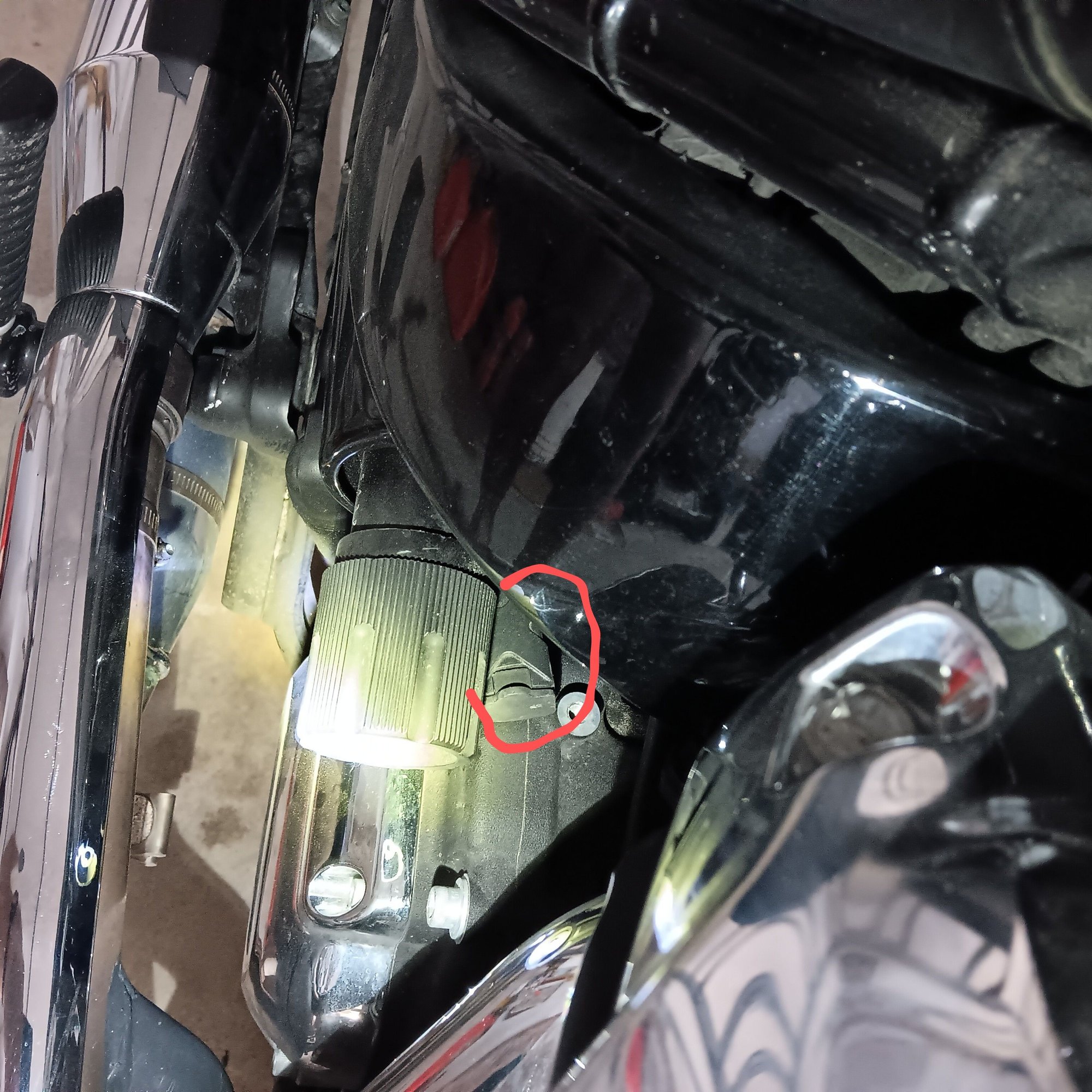

This is where I ran in on my wifes 2019 heritage,
