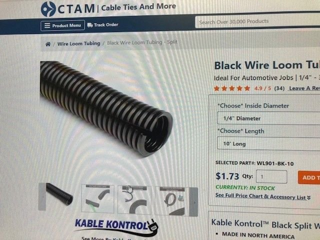

can you "armor" the cables ?

I actually had some silicon tubing leftover from my external breathers, worked well to cover the long extension when unscrewing the positive thru the frame, just made it more jammed. Actual ccover like that might be easier to manipulate. The garage I store in winter doesnt have power, once I get it running for the season its on the tender in my garage if its gonna sit a while. Im gonna give it another shot on a day im not trying to get done fast.
thanks for the idea!

Right or wrong, I like to tywrapp the cables tight so no vibration to rub insulation. I like to use loom or tape near rub points.
