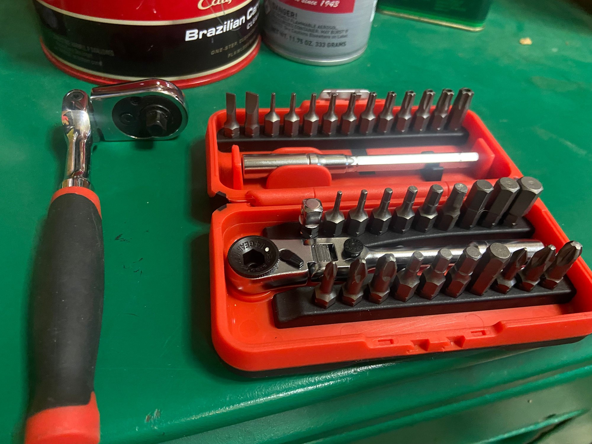

With this kit I was able to get all of the bolts off except for the one by the cylinder. I could get on it straight but could no get enough leverage.
With this kit I was able to get all of the bolts off except for the one by the cylinder. I could get on it straight but could no get enough leverage. Harley loctite.

Nice kit! What brand and where did you get that?

^That's exactly how I installed mine without removing the exhaust (although I installed the H-D version). @Axedude That kit is Icon brand, sold at Harbor Freight.

Can it be done without removing anything = Yes (I did). Would it have been easier without things in the way = Yes. I used the same Icon kit as @Durham man pictured above (found at local Harbor Freight). No need to pay someone, just get correct mentality, tools and patience.
