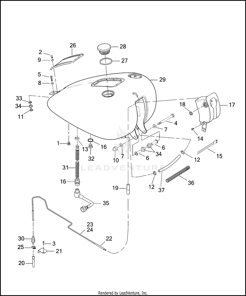

Get an OEM gas cap & Gasket. Buy once, cry once but it won't leak.
Does the aftermarket cap have a gasket? You may need to purchase just the gasket. If that does not solve the issue go all OEM
Ref:28
61272-92F
CAP,FUEL,RH-THREAD,FILLER,CHROME
This part replaces 61272-92C.
Price: $47.91
Ref: 27
61100194
CAP,FUEL,GASKET
This part replaces 61109-85D.
Price: $20.27
