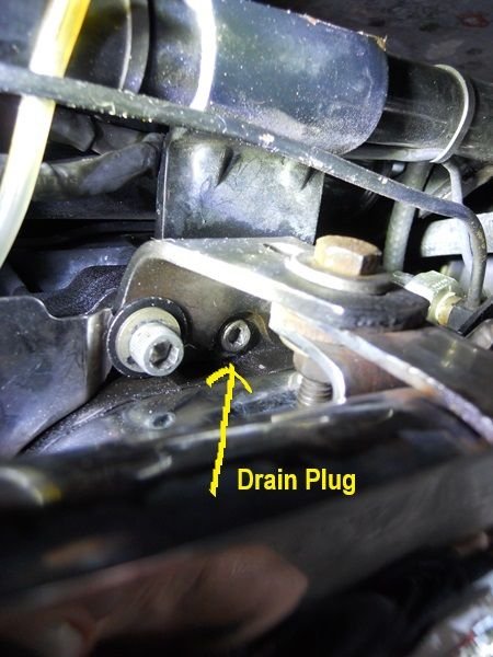

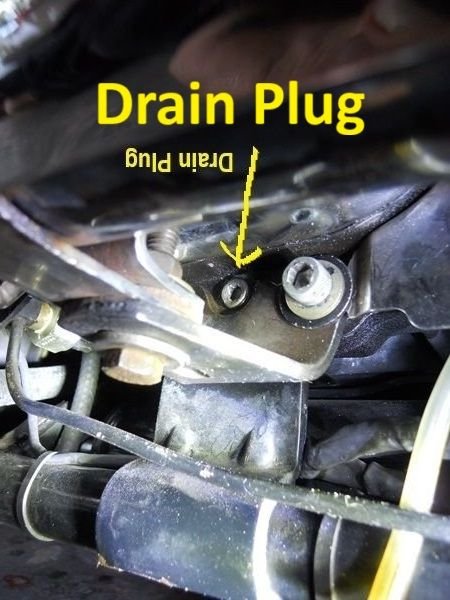

Hell, you ought to see the trans drain plug on my '93 Heritage.
Hey Man, your motorcycle is upside down...
Fixed it...
That pic had me going for a minute, then I realized it was upside down.
The OEM exhaust does not have that bracket, you just pop the muffler off and the plug is easy to get to.
