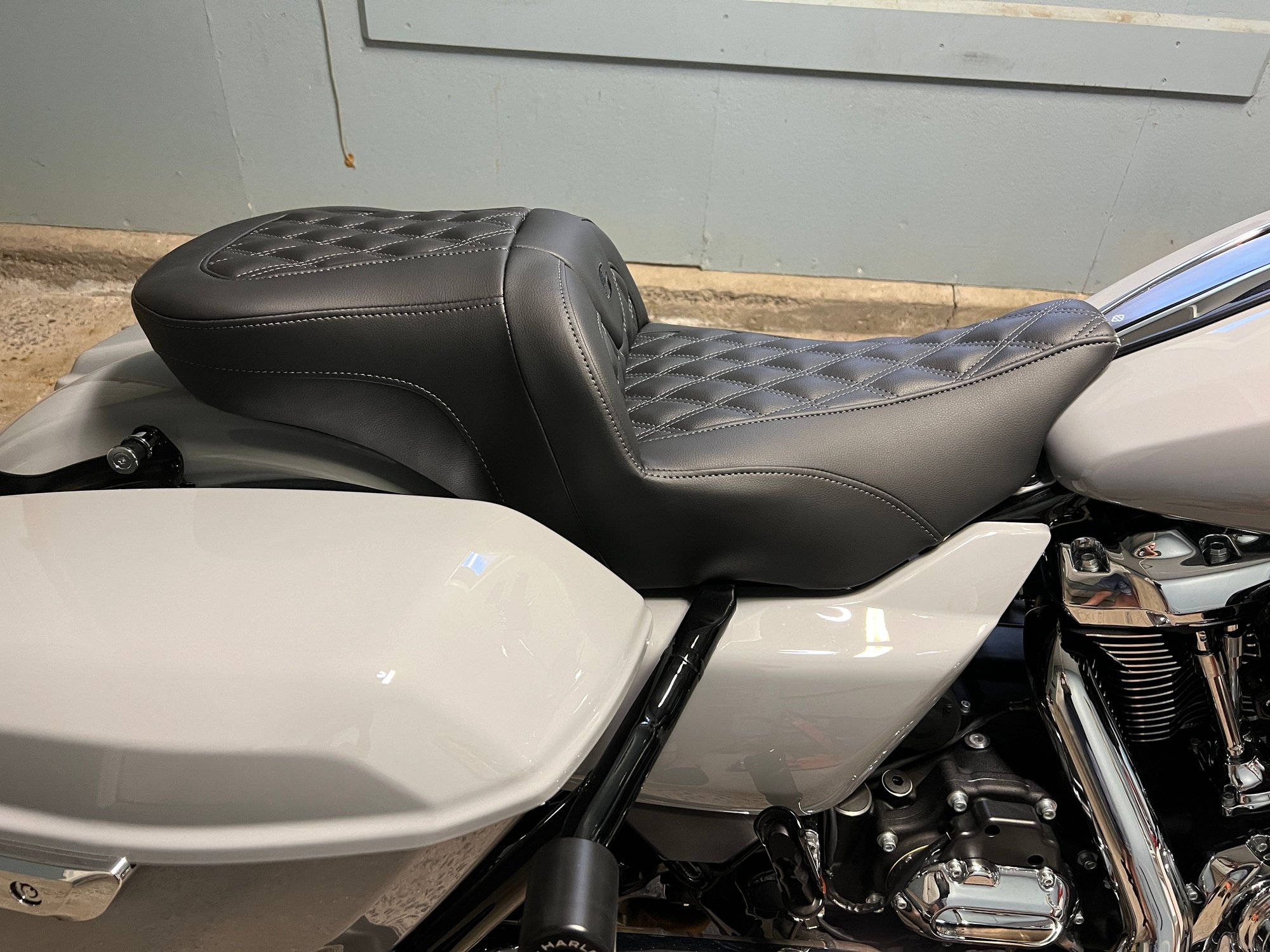

Hey Brandon,
I remember you had mentioned the fit of your Saddlemen Road sofa seat being poor.
I had ordered a Extended reach Roadsofa and also was disappointed.
When I lean forward to let my wife on the bike and go to sit back down, my pants crotch snags the front.
I drilled the tang bracket off the front bottom of the seat and made another plate. I raised the bracket bringing the front of the seat down tight like the Harley seat.
Much better and only took an hour since I had some metal plate laying around.
Seems like something Saddlemen ought to be working on.

Do you have a picture of what you did to the seat?
I also have a Road Sofa for my 24 Road Glide. 2700 miles on it and it is breaking in and getting comfortable. I definitely sits different than my prior Road Sofa that I had on my 2021 RGS. The 24 seat is narrower and sits lower. Looking at the bottom of the seat, it's obvious to me that they just cut a notch in the base pan, cut the prior square metal reinforcement bracket and riveted it on. The bracket from the tank has done a nice job tearing up the foam of the seat where it fits inside. It appears they rushed the seats and how did they miss making indentations for saddlebag guards?

I have a Road Sofa on my '24 RG with the new-style tip-over bars; it fits, there are notches but they're not exactly in the right location. The bars are right at the rear of the notch and there is no room to push the seat all the way forward. At least the mounting tab is slotted so it does fasten down and the seat sits flat. It's very comfortable. I don't have an older Road Sofa to compare it to. It does seem like the R&D for some of these products is incomplete.
