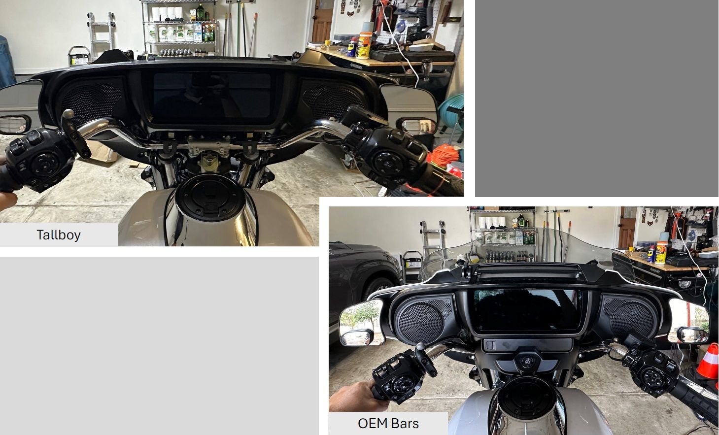

I just installed Tallboys on my SG last night. I did remove those hose clamps as suggested, but I still had a bear of a time getting the lever mounts back on the bars. It felt like I needed a lot of torque to properly seat the perch clamp halves and they still look like they're not seated correctly (I did double-check that the control harnesses are not being pinched). The brake line seemed very taught and the clutch cable's tube needs to be bent differently. I'm thinking about going ahead and replacing the clutch cable with a new version Fat Baggers released recently that moves the adjuster up by the clutch lever housing, so I'll likely just get one that +2". Still pondering the brake line (I really hate messing with paint-melting brake fluid).
Here's a back to back of the OEM vs. the Tallboy bars. The picture is taken at my eye level seated and as you can see, the Tallboy does not block the mirrors.
Yeah the clutch cable tube does need the bends opened slightly. Taxgod and I both did that simply by hand. Doesn’t take much. Doesn’t need much.
Did you follow my YouTube video for the install? I didn’t have any issue with the controls or levers going into place. It does help to lower the bars first so you’re not trying to wedge them between bars and the fairing.
My arms were in the way of the mirrors, not really the bars in the way.
I really find it odd that Taxgod didn’t have to remove the p-clips from the triple and had plenty of length on his clutch and brake lines, I had to remove the p-clips to get enough length, and you say they’re too tight even with the clips removed.
