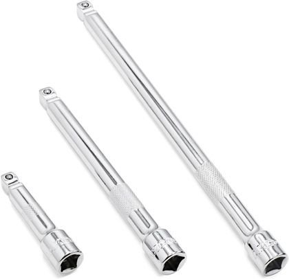

To get a torque on the plug get a set of wobble extensions and hook them up so they come out the front of the bike and have enough room for your torque wench.
Amazon has them, Harbor Freight also. You could also use just regular extensions with a flex adapter.
