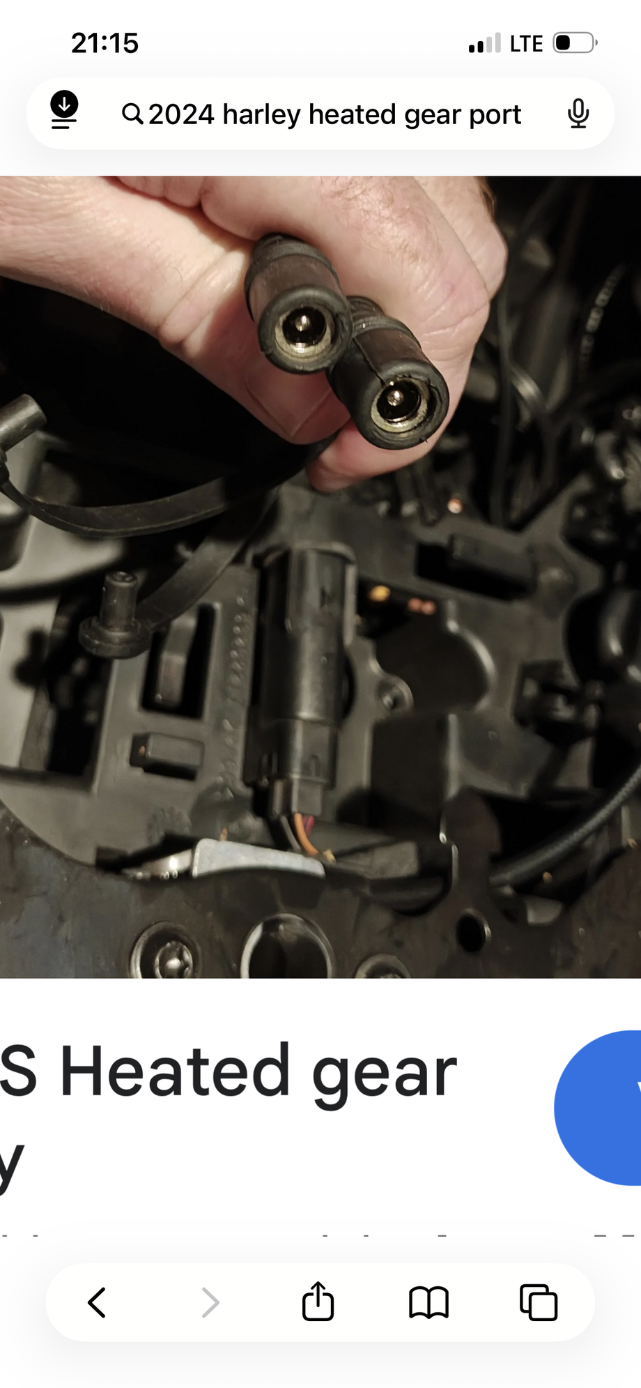

I have a friend who just bought a 2025 Street Glide Ultra and there is a heated gear connection under the seat.
I expect your ‘25 CVO would have same.

Originally Posted by Goose_NC
I highly encourage you to connect the heated gear direct to the battery using the cable provided. That removes that load from the bike wiring.
The 24 and up have factory ports specifically for this.

There is the plug in power port built into your bike for heated gear. But if you're not going to use that, or not able to because of plug incompatability, you'll need something like this to plug the controller into:
