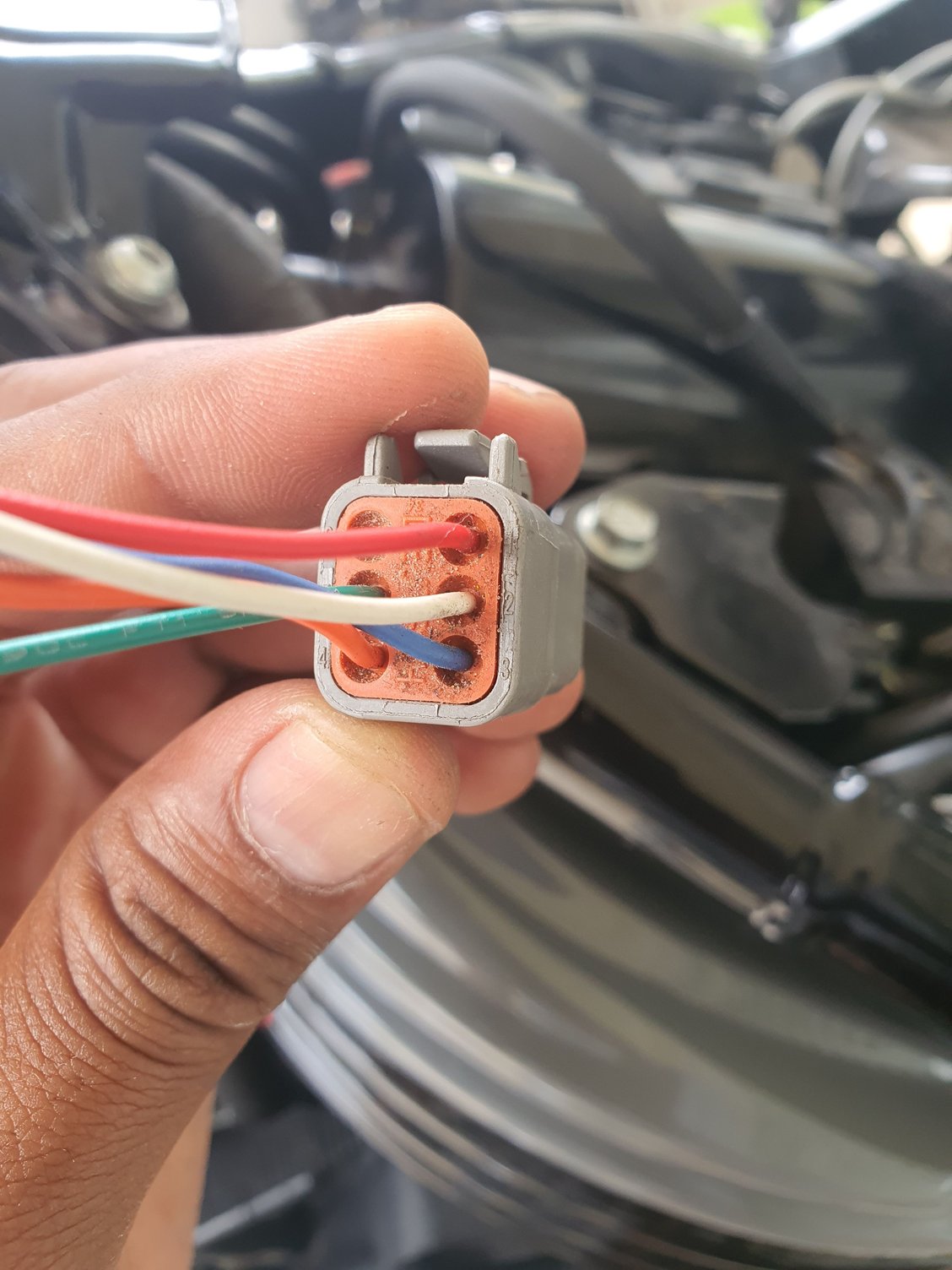

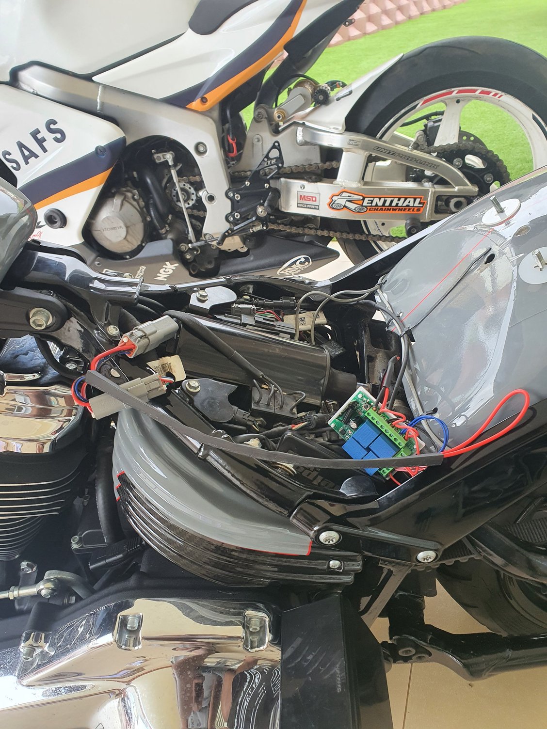

Using a 12v 4ch Wireless Relay, 6 Pin Deutsche connectors for a Pnp solution. Should anyone have interest or require assistance to achieve a similar setup, please PM me directly and I will gladly assist.
Red wire is +ive 12v source, 4 other wires function as follows Front Up - Green Front Down - Orange Back Up - Blue Back Down - White
Testing..... functionality
