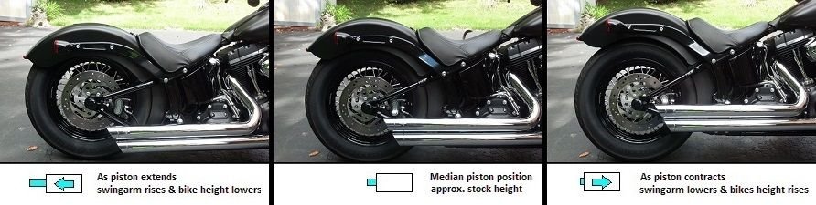

Using the previous diagrams as a reference, as you add air to the UP chamber, the piston pulls back, or contracts into the shock, causing the swingarm to lower, and the bike to rise up. (see Fig. 4)
Alternately, as you add air to the DOWN chamber, the piston moves out, or extends from the shock, causing the swingarm to rise, and the bike will lower. (see Fig. 5)
We’ll get into rebound in a bit, but first a quick word or two about air volume –vs- air pressure.
- Air VOLUME is the amount of AREA that air occupies in an enclosed space.
- Air PRESSURE is the DENSITY of the air within that same space.
In the case of the SS, it is air VOLUME (in both chambers) that determines HEIGHT via piston travel, and it is AIR PRESSURE (in both chambers) that determines REBOUND.
Here’s how differences in air VOLUME (area) between the two chambers affects HEIGHT:
Fig. 9

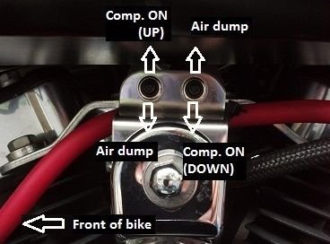

Let’s have another look at those switches.
Fig.11
Now again, bear in mind that I’m showing the operation of the switches in their most recent revision, so once again I can’t guarantee that earlier models function in exactly the same way…
Each switch is a single-pole, double-throw (SPDT) electrical switch – meaning that each controls a single function (or circuit) but it flips in two directions.
In this case each switch flips up AND down, with the center position being neutral, or OFF.
Both switches are also of the “momentary contact” type, meaning that no matter which way you flip the switch, it will only remain there as long as you hold it.
Once you let go, it will spring-return back to center (OFF).
(Note: Older revisions of these switches were quite different in that one direction (up) would lock on, allowing you to let go with it still running. This was changed in later revisions, probably to prevent you from burning up your compressor by leaving it running for too long. Also, the orientation of the switches was changed as well, but I won’t get into that here.)
The current switch operation is as follows:
1. The FRONT switch operates the UP chamber.
2. Flipping it UP, turns on the compressor and fills the UP chamber in the shock.
3. Flipping it DOWN releases the air valve for the UP chamber, dumping the air.
4. The REAR switch operates the DOWN chamber.
5. Flipping it DOWN, turns on the compressor and fills the DOWN chamber in the shock.
6. Flipping it UP releases the air valve for the DOWN chamber, dumping the air.
7. Both switches can be feathered or “blipped” in short bursts without harm – in fact as you’ll see later, this can be quite useful.
If you haven’t noticed, the UP and DOWN operations are reversed from one another…
(look at Fig. 11 again)
ie; the front switch (UP) turns on when UP, the rear switch (DOWN) turns on when DOWN.
This makes sense strictly because of the movement of the bike.
Up is up and down is down – as it should be.

Despite my "exaggerated" diagrams, the actual piston/ram travel is only ONE INCH, but coupled with the geometry of the swingarm and its pivot points it allows for a full 5” of height adjustment.
On my bike that’s 2.5” lower than stock (slammed), all the way up to 2.5” higher than stock.
Fig. 13
Look above (Fig. 13) at not only the fender height, but also the relative locations of the top of my exhaust and the axle nut. That’s quite a difference from one extreme to the other.
The same goes for rebound – a medium setting is very similar to the feel of the stock shocks. But with the SS, I can increase or decrease rebound far beyond the capability of the stock setup.
That alone, in my opinion, is an engineering marvel and a thing of beauty just for its perfect symmetry in both cases…

But rather than just parking and dropping it, try this;
Hit the DOWN dump, this will raise it all the way up in about a second.
THEN hit the UP dump, this will slam it just as fast… that’ll get their jaws droppin’.
