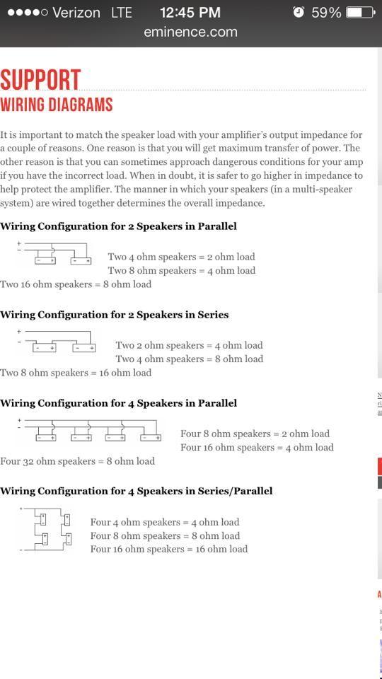

I am looking at ordering the Infinity Kappas and the Ks 125.4 mini amp. The speakers are two ohm.
The amp states.
Power @ 4 ohms (Bridged): 2 x 250 watts.
How do you set it to two channels or how do I get the most power to the speakers.
Limited setup
Any special wiring harness needed?
Thank you in advance

Nothing Special. Can't bridge that amp with 2 ohm speakers only 4 ohm. 125 watts RMS is plenty for the kappa's. You will only run on two channels. Use the other two channels to upgrade.
