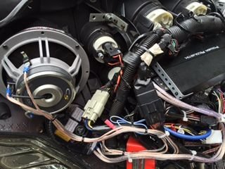

As you can see the PA fits nicely between the vertical brackets. Tight but fits.
Here you go John. These were quick and dirty pics but I think they illustrate what you need to see. This configuration is what worked for me. Disclaimer: Has not been approved by AAWAV or NUTZ LOL.
I used the screws from the amp itself to attach the amp to the black vertical brackets. If you pull the amp all the way back to the gauges the brackets fit perfectly and holds the amp in there nice and tight. I only took a pic of one side but the same configuration is on the other side. As stated in an earlier post the amp will sit about 1/4 inch off the HU. Hope this helps my man!
