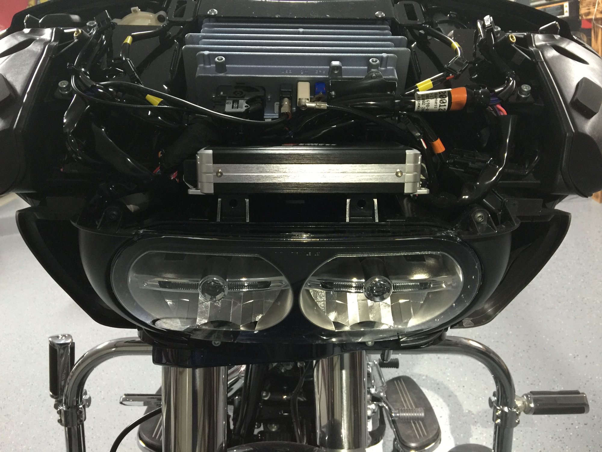

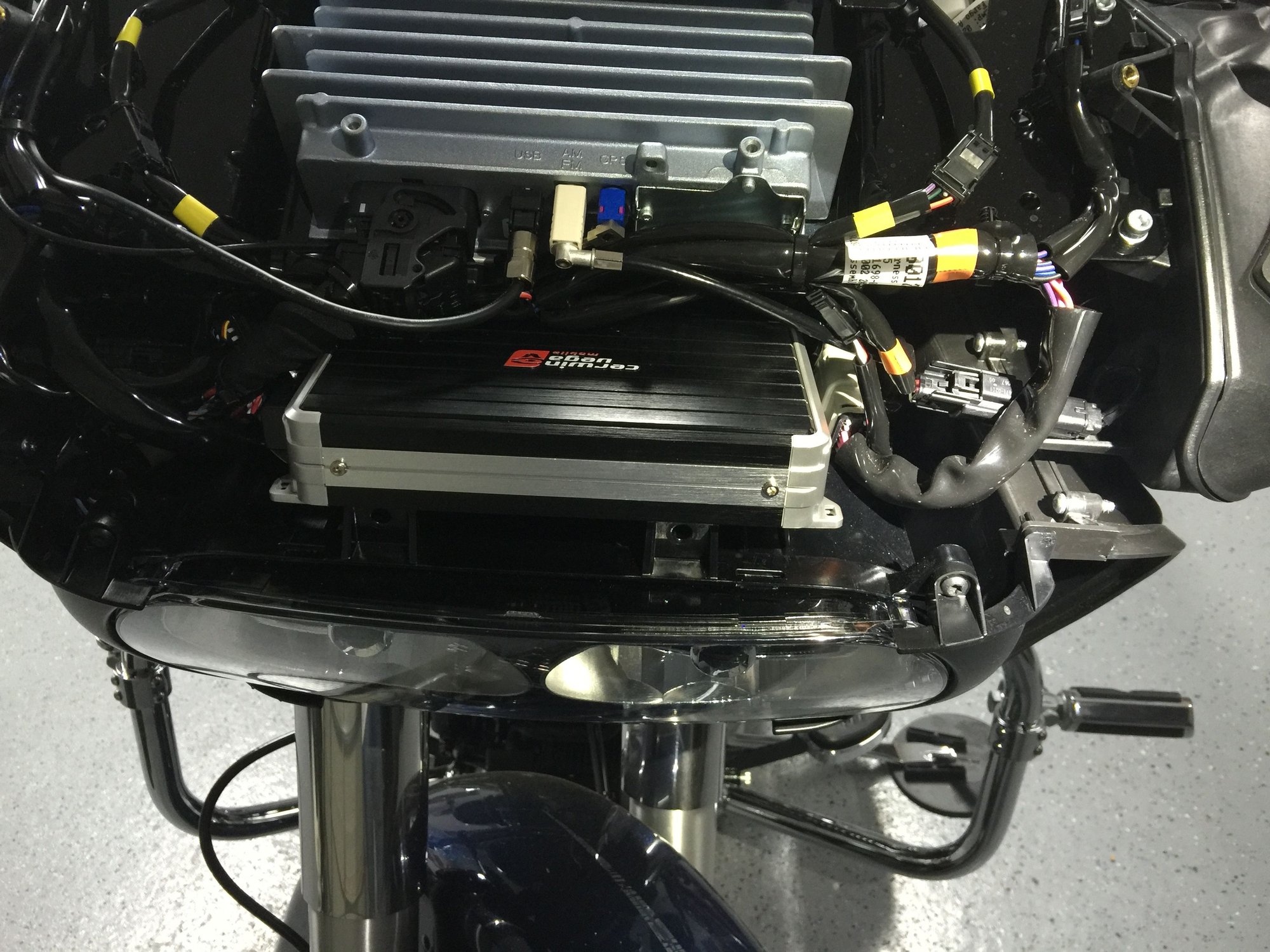

Where are you guys securing your amp? This is the cerwin b2 just slide in place.

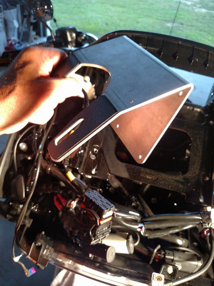

My much smaller BT 4180 is in the same place..
This bracket bolts under the radio to make a shelf where the BT amp sits directly under the stock location. I didn't get clear instructions from BT,, but it took me about 45m to figure out where it went is all...LOL

I would fabricate a bracket of some sort out of aluminum to bolt where mine is,, and mount the amp into it there, or two brackets, and bolt the amp to it,,, your amp is much larger than my BT is for sure.

Got same issue but thanks for the pics and video i will try and make a bracket
but in case I can't where did you buy that bracket
never mind found that on biketronics site
