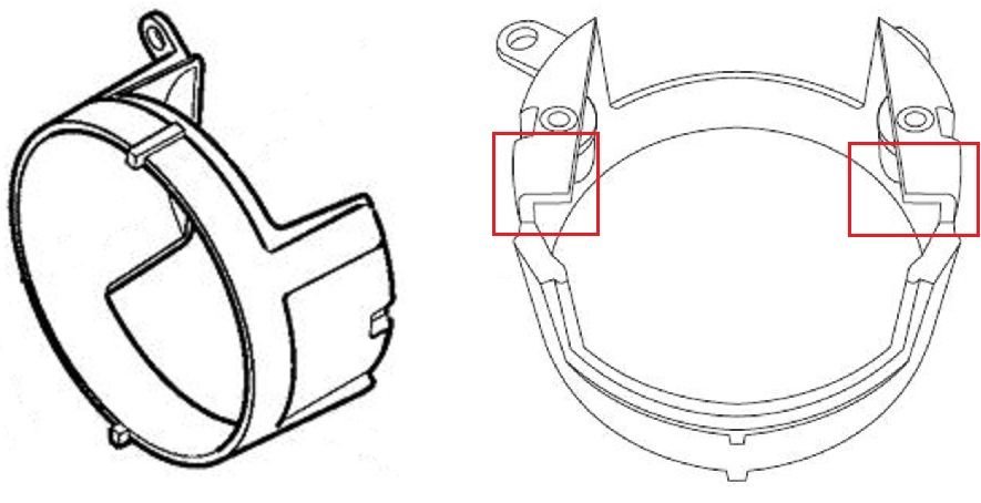

Notch out your gauage bezel retainers. The black part inside inner fairing. Cut below the studs out.

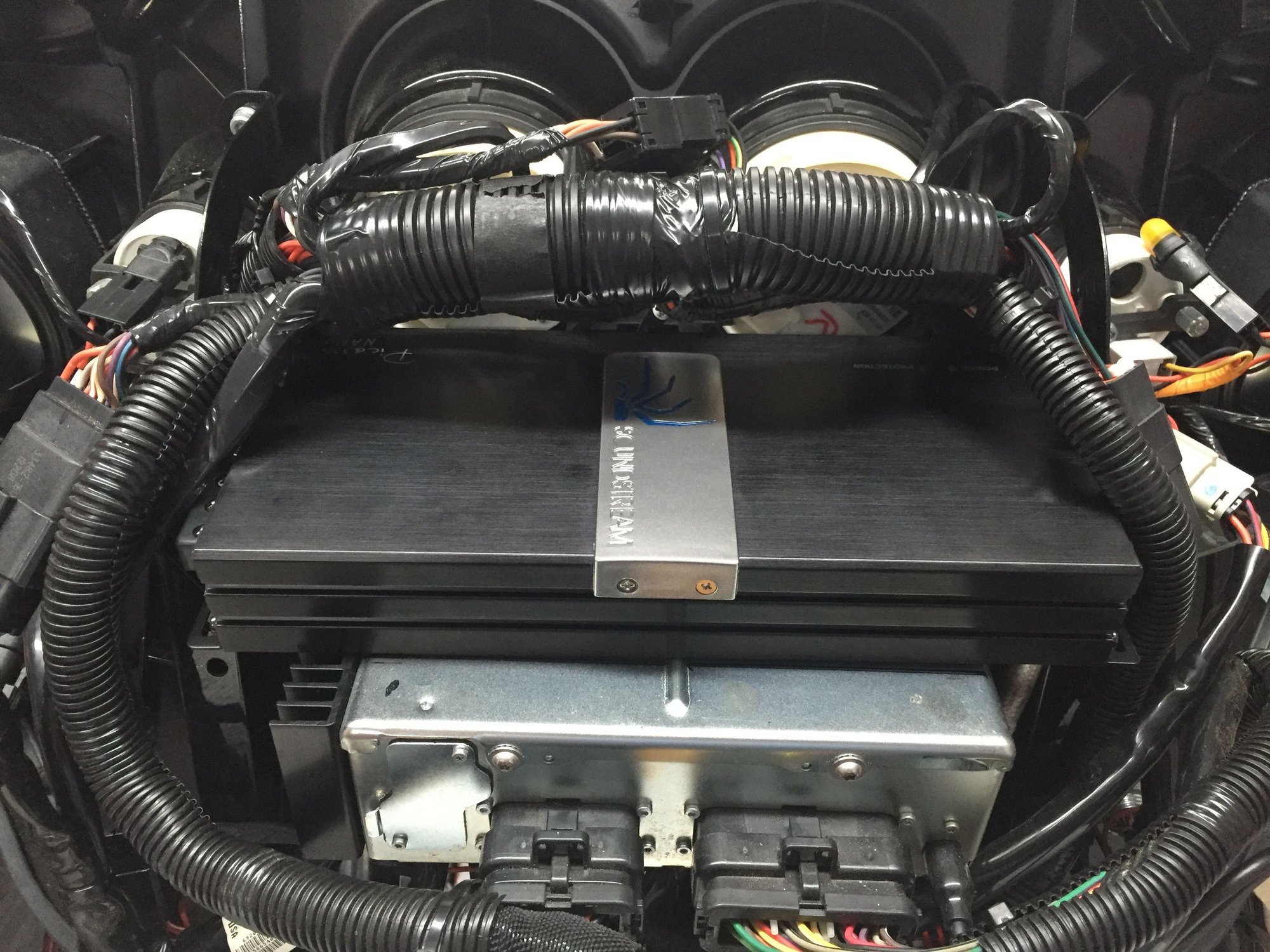

This is a pn4.1000 on '13 stock hu, with bezels trimmed.
Here's where the problem lies with your pic, you have it hooked up using high level inputs. When using low level inputs you have to be a little more creative because the rca's will hit the fairing brace. Amp will need to be mounted more on a slope to fit.
The pic is only of it setting in place, not hooked up yet but have made bracket to raise the "back" of amp along with some "work" on the brace for rca clearance. It all dry fit good so far, but with me...........
The pic is only of it setting in place, not hooked up yet but have made bracket to raise the "back" of amp along with some "work" on the brace for rca clearance. It all dry fit good so far, but with me........... -Greg
Yessir mine dry fit easy peasy too but when everything was attached it was a different story.

cut these pieces off on both speedo and tach black plastic bezels. this will allow the amp to slide back another 1/2 - 3/4"
