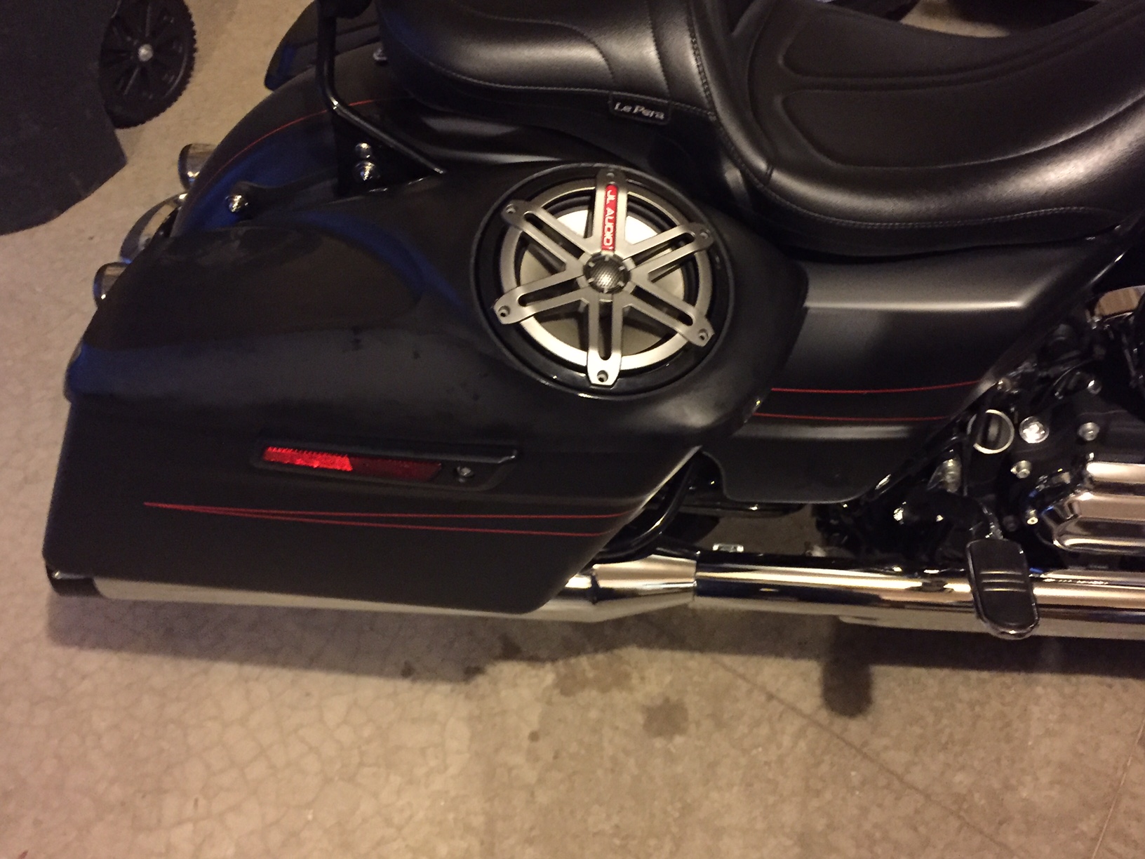

All the pieces should get to me by next weekend to get to work on the fairing. I have the Arc 600.4amp, 2 BT LL and 2 Crossovers for the JL 6.5s to mount. Can I put anything on top of the amp? or is heat a concern? Dbl sided tape, Heavy duty Velcro? What's the best way to mount all this stuff? Wanna stay away from my big roll of silver duct tape!
Mocked up the lids prior to sending them out for paint...

Are you using the Biketronics speakers brackets?
The amp will take up most of the real estate on the amp mount in a RUSHMORE and the cross overs along with the bt355s will take some creative placement for clearance for the fairing to go back on but it is all doable.
But they will not fit in top of the amp

I will be using the BT Speaker brackets. The crossovers are about 5 3/4" long X 4" wide and 1 5/8" tall

One will fit on the clutch side vertically Velcro and zip tied while the other can go beneath either speaker horizontally with Velcro on the edge of it and zip tied around the speaker sprocket.
