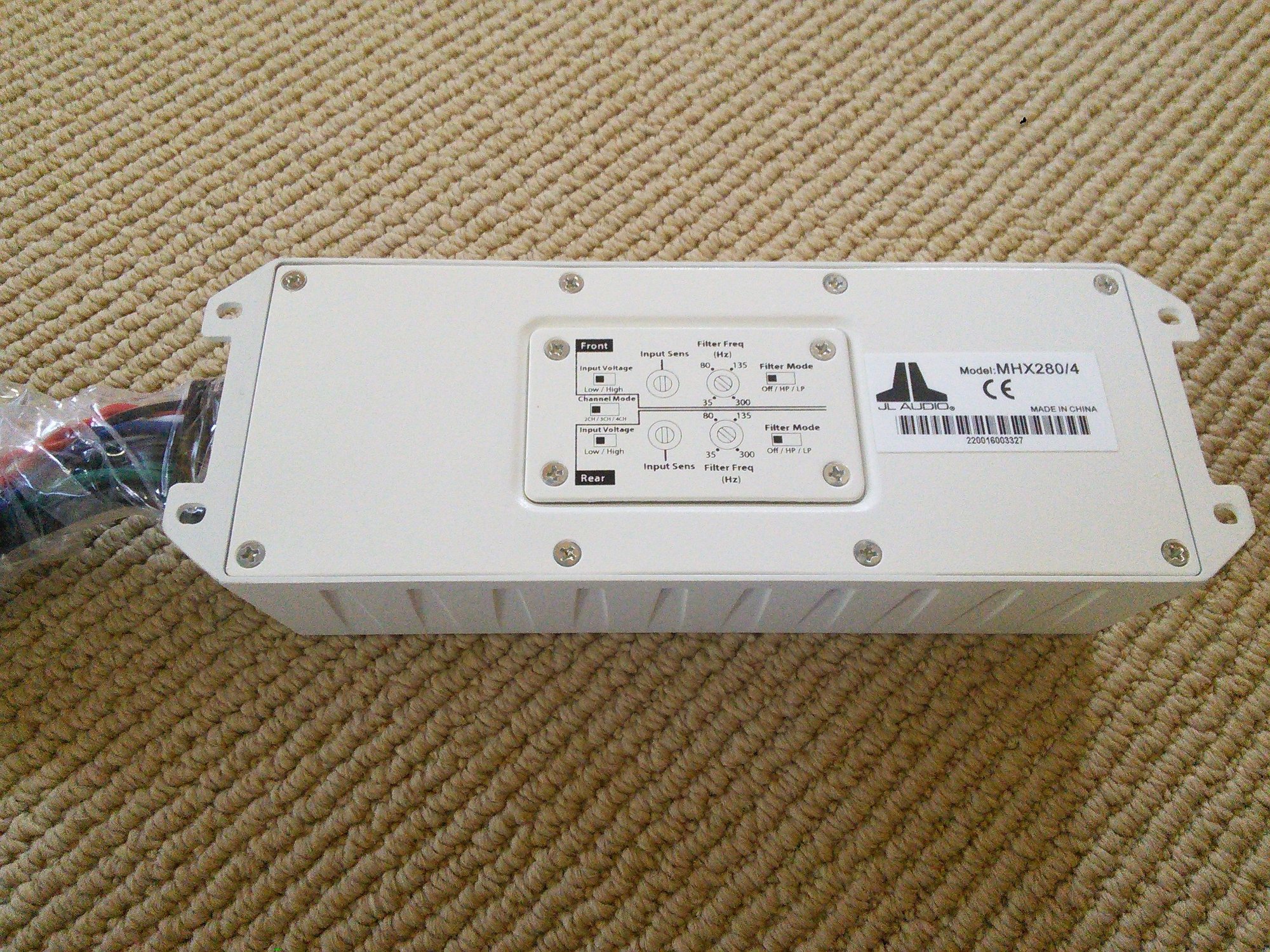

  1. I got a recommendation to mount the amp with Velcro. The problem I'm seeing is that the access panel for the amp would be covered. I could cut a hole in the Velcro, or I could fabricate a mounting bracket....

Once you set the gains on the amplifier, you won't need to access the panel on the bottom of the amp.
Even though the 3M Industrial Velcro and/or 3M Body side-moulding tape will hold your amp very secure, I mounted my MHX280/4 to an aluminum plate with screws. When the temperatures hit 100+ here in West Texas, I've had the Velcro come unglued. The Side-moulding tape has never failed, but is a one-time use product.
