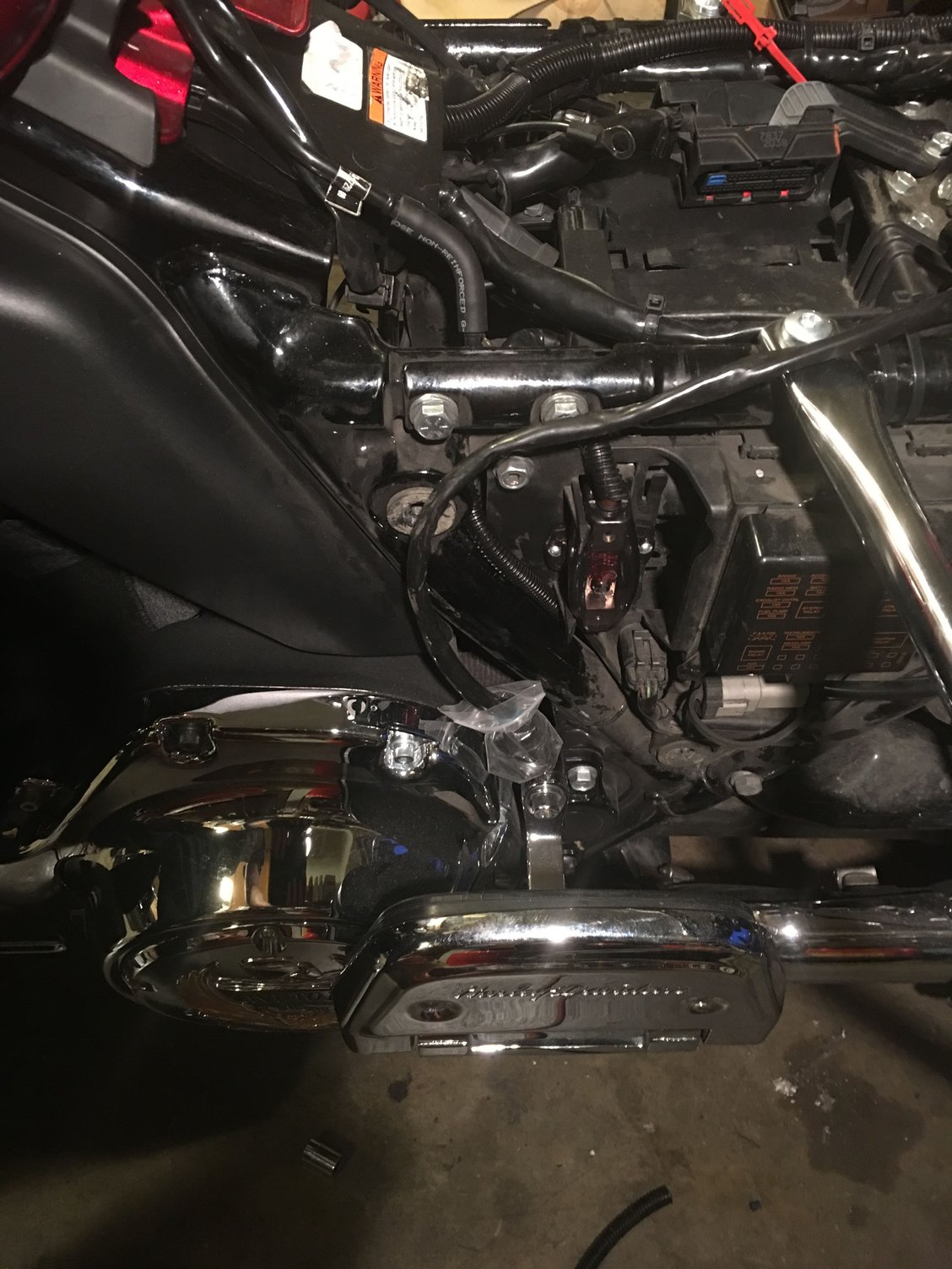

This is where I mounted mine next to the ecm plug on the empty plastic on a 2012 limited
