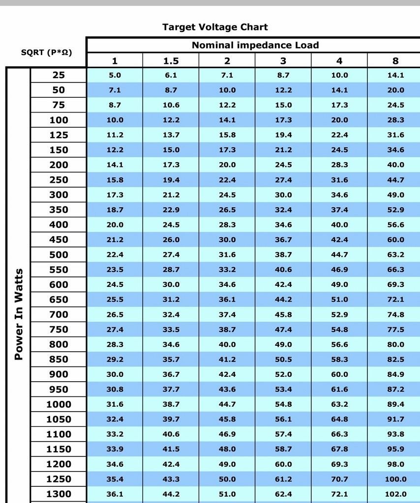

Default Gain Voltage Chart
Photobucket is useless now unless you pay them $60 a year to host pics. That isn't happening from me. So until Nutz gets back, here is the gain chart again, until the sticky can be modified. It is locked and only a mod can unlock it to be able to modify it.

Dudes can just download the free Ohms Law Calculator app as well.
Works damn good.

The DD Audio Toolbox app is damn handy too.

Yep. I use both of these. The test tone generator is a nice feature on the DD app too.

The Tone generator on the DD app is high like maybe 0Db
