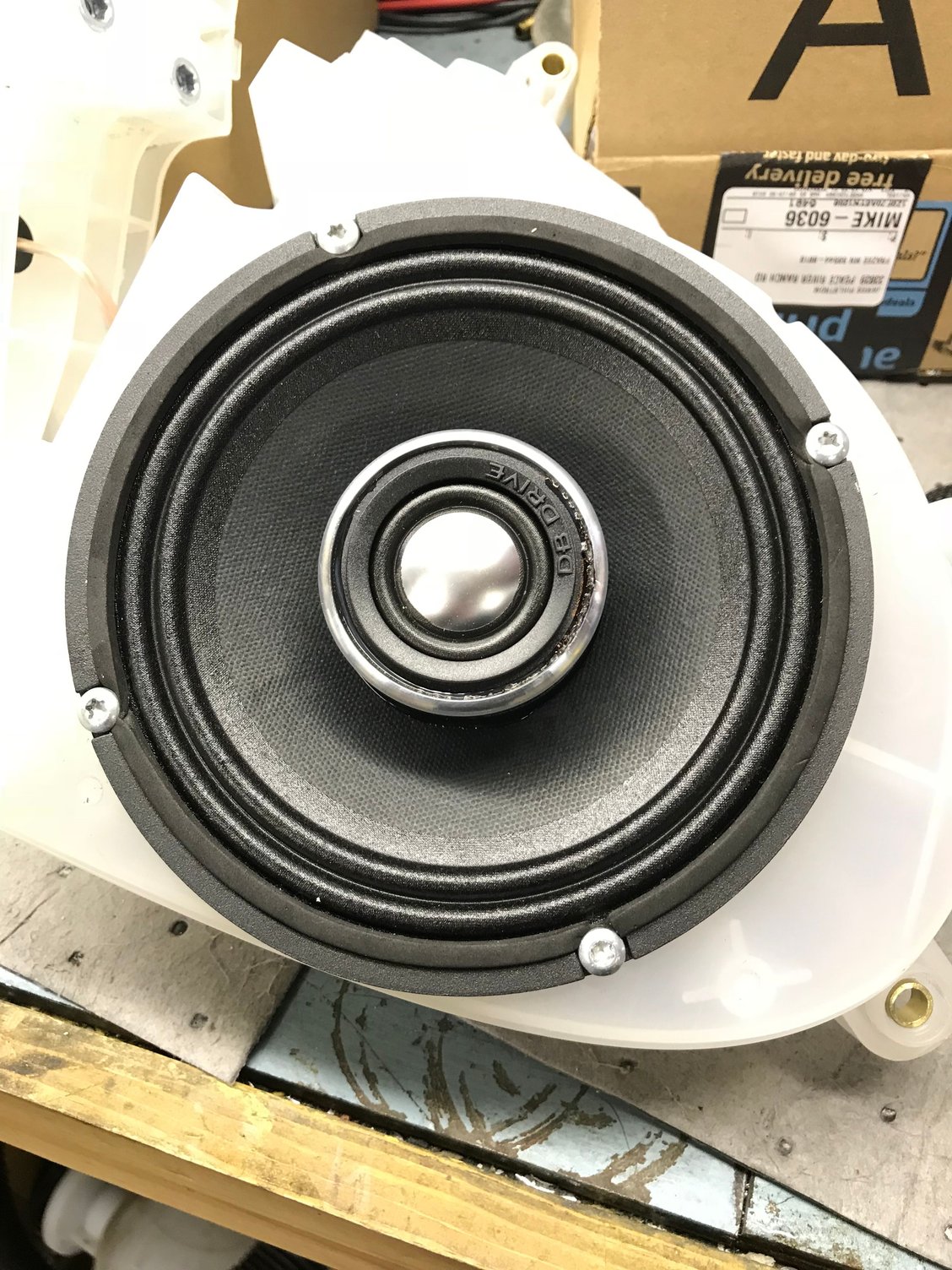

the wdx6moto speakers will fit in the factory fairing pods with minor mods.

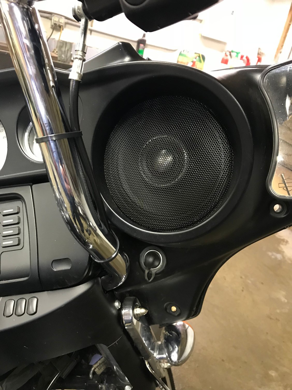

I recently installed a set on a friends 2016 flhx. I had to trim off the indexing tab on the face of the pod, then trim about 1/2 off one of the internal ribs. Also removed the tweeter grills and used hog tunes grills.
